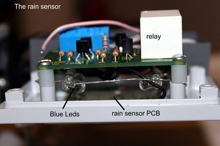

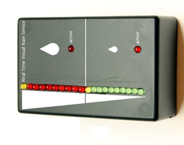

The rain sensor will become active at the presence of water drops. with the use of a relay then all other circuits will be powered.
Following, a microphone per-amplifier located under a reversed stainless steel bowl (acts like a bell), collects the sound of the rain drops. The amplifier multiply the signal from the per-amplifier and drive the VU meter where must be visible and most likely indoors, near you.
If it drizzle, some leds will light up but not all. If the rain is strong enough then all the leds will light up and with greater frequency. So, using this method one can have an idea on rain conditions.

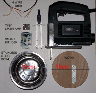

Step 2: GATHERING THE MATERIALS
Two (2) set of the above can be used.
A 3 wire cable plus ground = 4 wires, Length = from the VU meter to Project placement + 1meter.
A 2 wire cable for powering the circuits. Length = from the 12VDC power supply to Project placement.

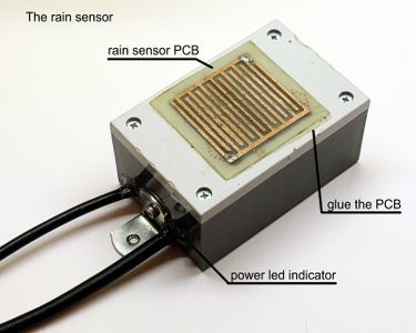

A Rain Sensor like the one I used. SMART KIT 1080
http://www.quasarelectronics.com/smart-kit/1080-liquid-level-sensor-or-rain-alarm.htm
http://www.smartkit.gr/electronic-kit/automation/liquid-level-sensor-rain-alarm-m.html
A plastic waterproof box for the above.
A 8 wire electric screw connector. A plastic waterproof box for the connections.
A microphone Pre – Amplifier capable to drive an electret microphone. SMART KIT 1193
http://www.quasarelectronics.com/smart-kit/1193-super-microphone-preamplifier.htm
http://www.smartkit.gr/electronic-kit/preamps-mixers/microphone-pre-amplifier.html
The tiny LM386 amplifier (see my instructable) or any low power less than 1watt.
LM3915 VU meter.
A box for the above
Stabilized power supply, 12VDC / 500mA. Purchase one or build the circuit from this instructable.
Thin stainless steel bowl with diameter of 16cm – 20cm.

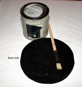

Piece of wood, thickness about 1 cm x bowl diameter.
Some water proof wood protective varnish for the above.
TESA moll - self adhesive rubber for windows, not more than 50cm.
Instant glue,use it to glue the sensor PCB at the top of the rain sensor’s box.
About 15 stainless screws of 4mm in diameter x 20mm long , nuts and washers.
Aluminum, stainless or wooden rod about 50cm long. A bracket base to hold the rod depending on where you are going to place it.

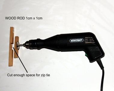

Step 3: CONSTRUCTION
I have included step by step pictures for the construction to make it easy for everyone to follow.

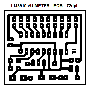

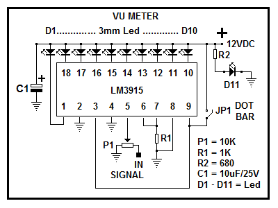

Step 4: LM3915 VU Meter
PARTS LIST
R1 = 1 KOhm
R2 = 680 Ohm
P1 = 10 K vertical multi-turn trimmer (POT)
C1 = 10uF / 25V electrolytic capacitor
U1 = LM3915 + 18 pin case
D1-11 = 3mm Led any color
Connectors = 2 pin screw PCB connector (x2)
JP1 = 2 pin PCB jumper (male,female) pitch: 2.54mm (= 0.1”)
Spare wire from used resistors
A plastic box to place everything inside

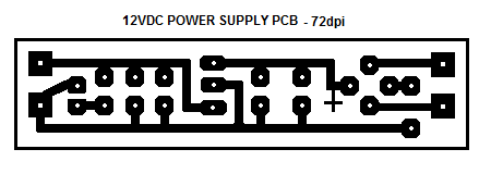

Step 5: 12VDC STABILIZED POWER SUPPLY
PARTS LIST
R1 = 680 Ohm
C1 = 1000uF / 25V polarized electrolytic capacitor
C2,3 = 100nF / 50V ceramic capacitor
C4 = 10uF / 25V polarized electrolytic capacitor
BR1 = 1A / 250V bridge
U1 = LM7812 & heat sing
One screw about 4mm in diameter x 10mm long,nut and washer
D1 = Led 5mm red
TR1 = transformer 15VAC / 500mA
SW1 = ON / OFF 1A, switch
FUSE case & fuse 1A
220VAC MAINS wire with plug

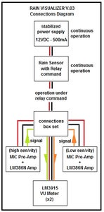

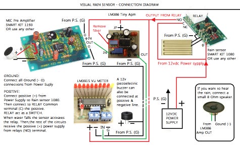

Step 6: FINAL ASSEMBLY AND CONNECTIONS

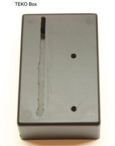

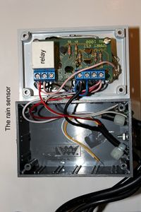

The rain sensor PCB and the rain sensor circuit goes to one waterproof plastic box.
Collect all cables to one waterproof box and make the appropriate connections using the 8 wire electric screw connector following the connections diagram.

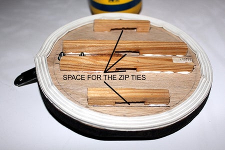

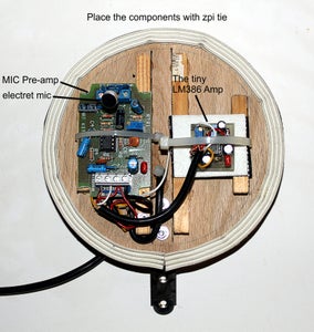

Using small metal corners, screw to the rod the rain sensor box, the connections box and the bowl construction.
