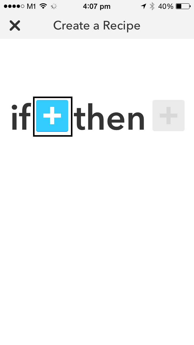

Step 6: Configure the Apps
1. connect to maker channel and Assistant channel on IFTTT
2. create a IFTTT recipe
Step 7: Test It Out!
