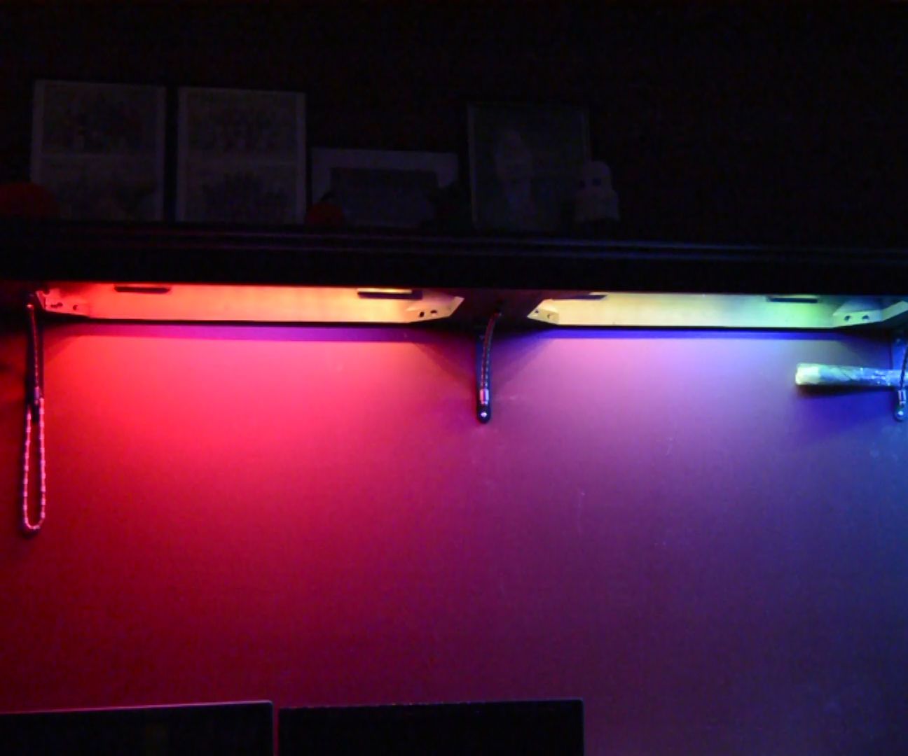

Step 10: All Done - Watch It Run.
So everything should be saved, you should have uploaded the new sketch to your Arduino and have everything connected. If everything went right you should be able to repeat what occurs in the video. That's it for this instructable I hope you enjoy it. I will be entering this one into the Make it glow contest so if you like it please vote. I could really use the 3d printer to make other instructables and projects.
