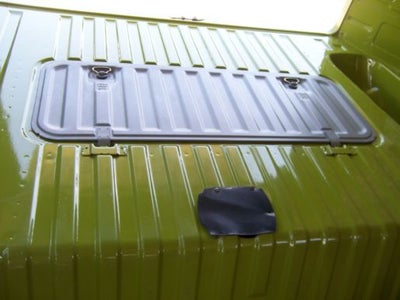

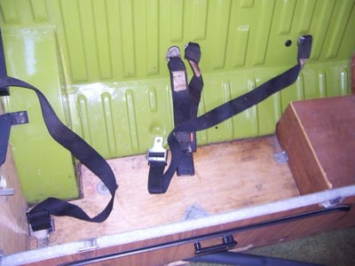

Easy really, 8 fasteners on each seat. I found that if you lay the seats out into the bed position, then fold the bottom up over the back (top) bench, you get perfect access to the screws. When that's out, the access to the top seat is from under the seat, ( you have half your body in the tool area, you might want a towel or drop cloth).
mmmm no these areas were not this clean until the seats were out.

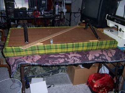

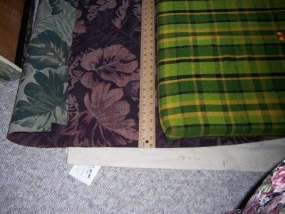

Measure your seats, Add 1 inch to each side . I Add an inch, because I wanted room for error. I also want to be able to re-pair a seam in the future if I need to. When I designed my seat covers, I made the font , top and bottom , one continuous piece, the the sides were separate. Then I added 1 inch to each side to be stapled for staple room)
Example: Top seat dimensions - 17"h x 43"w x 3"d
so my fabric cut to front: 27" h x 45" w
side 19" w x 5 " h
Cut Your Fabric to Your measurements.

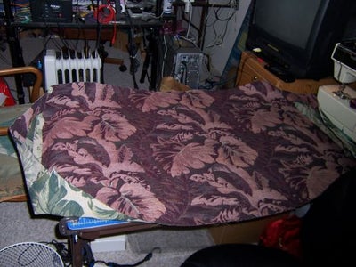

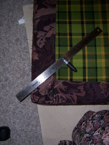

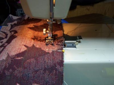

From here all you need to do is box your corners. Position the side piece in the mid point of the front cover, sew it on. Start you seam inch from the beginning and end the seam 1inch from the end of the fabric.
Iron the seams flat. Where the seam starts and stops is where the corners will end up, check to see if its coming out as you want now, it will save you time later.

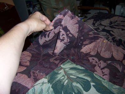

Now bring up the flap edge to match the long edge of the main fabric. Line them up and the it will square the end for you. pin it. (If my directions are hazey , sorry. The pic shows it all)

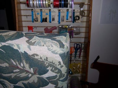

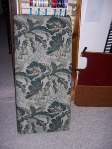

You will end up with a big floppy boat if you have done it right. The seat should fit in some what snugly, if its too loose, it will wrinkle and pucker. The corners need to line up nicely also. The first one I did came out perfectly the first time, the second took several fittings.

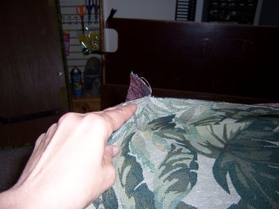

I Put the seat on the floor upside down, sat on it and Stapled the edges. Pull the Fabric taut as you go , Fold the edge under 1/2" and staple BOTH layers so the Fabric doesn't just unravel . Like any upholstery project, Start in the middle of the piece,staple evenly, working your way around evenly. I guess I mean; if you do something on one side, do the same thing on the other side.
I started on the sides, did them together, then worked the top and bottom at the same time.

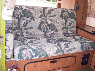

As you might have noticed, I did not take off the original fabric. We want to keep things as authentic as possible, preservation and conservation is our main goal.
Voila!

Step 7: Re-Install

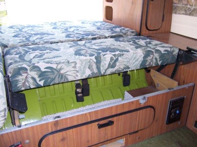

Reinstalling the seats was pretty easy , except for the bottom Bench. It took a while to realize that it had to in an vertical position. It took a bit of oomph to hold it up and put the first 2 screws in. Of course there was probably a better proper way, but all turned out well.
