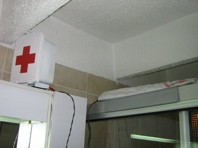

Imagine this: You go to your bathroom and sit in the peace and tranquility of your toilet when... a big splash of water falls from the roof and make you look like a wet dog!!!
Well, this was an annoying prank when I was in the Navy, and watching "Lethal Weapon 2" gave me the idea: if I could make the same joke, but activated when the guy sits in the toilet? MUAHAHAHAHAHAHAHAHA!! IT'S PAYBACK TIME!!!
This devilish prank works in this way: when the victim sits in the toilet, press a switch. The switch activates a motorized device, disguised as a first aid kit in the top over the toilet, and drops a big splash of water.
BUT WAIT!!! I want to say to the victim "HEY! YOU WAS MY VICTIM!". I want to say "IN YOUR FACE!!". I want to say "YOU'RE MY B...!!!".
And for a geek, all those sentences are summarized in one single word: "BAZZINGA!!!"
So, when the water drops, immediately a "Bazzinga!" drop-sign will fall. And the poor wet human will be noticed that he has fallen for one of my classic pranks (thanks, Sheldon Cooper!!)

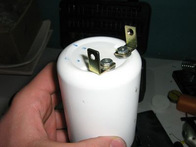

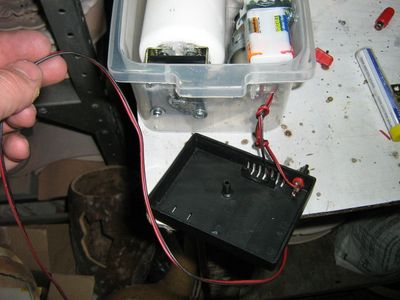

Step 2: White Box!!
How to build the fake first aid kit.

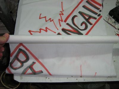

Step 3: BAZZZZZINGA!!!!
Well, time for the "Bazzinga!!" drop-sign.
Step 4: Installing And... READY!
Time for put the trap! MUAHAHA MUAHAHA MUAHAHAHAHAHAHAHA!!!
