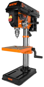

Introduction: WEN Drill Press Table Adjustment Handle Extension
If you own, or intend to own, a WEN 10" Drill Press and you add a table and fence (or build your own) you will find that the height adjustment lever will be difficult to reach and will hit the table unless you move it forward plus you will lose valuable workspace.
So this instructable is designed to help you easily add an extension to the adjustment lever without making any permanent changes to the Drill Press.

Step 2: Remove Handle
First you'll need to use an Allen wrench to remove the height adjustment handle from the back of the drill press. Make sure to keep the supplied set screw with the handle for now to not misplace it.
I'm showing a stock picture here to clearly show the lever so do not remove your drill press table (DPT) during the process.
