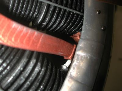

Step 3: 1/3 Scale Dummy Le Rhone Radial Engine Complete With Spark Plugs.
The 1/3 scale engine was designed using CAD and then sectioned so that the parts could be printed due to their size.
The parts are glued together using ABS glue and then painted so that it look realistic.
If you brush acetone onto printed ABS parts it generates a smooth finish and can give a more desirable texture
If you look closely you can even see the spark plugs.
There is a 200 watt sound system between the dummy engine and the real engine. This sound system when activated plays the sound of a real Vickers machine gun firing.
There is a very powerful LED light in the muzzle of the gun and this flashes in time with the machine gun firing.
All this is activated by the transmitter.
