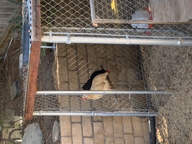

A note about those predators u mention- its HIGHLY advisable to use a cement or raised wood platform for the flooring + cemented in side posts. Possums, raccoons, coyotes, fox, etc WILL dig under a fence and into the coop that doesn’t offer protection for all sides, including below. Once they find the chickens in a coop they’ll keep trying so unless you’ve got a full-time outdoor guard dog (& even then) its important to think of every angle. If no floor is being used then its important you dig down at least 1.5’ and bury a steel or equally strong barrier to prevent those animals from getting under the sides.
Also, chicken wire is nice & allows the coop to be visually less intrusive but its not strong enough to protect the girls overnight. A coyote will run right through it, coons will bend it apart to create a hole, etc...if its the only thing used then I’d suggest that its triple layered with overlapping hole/joints.

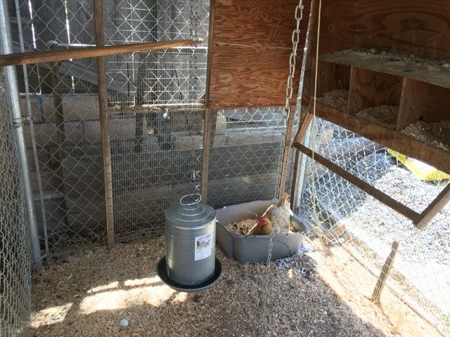

We also made our open-aie coop in the corner of the property that has protection on 2 sides via the wood fence & block wall. Due to coyotes & raccoons we laid a cement pad, using steel posts, chain link fence sides, and chain link door with steel frame (roof is corrugated metal). The door latch also received a lock hole to prevent coons from opening the simple flip down gate latch (yes- they are that smart :/).
A benefit to using chain link (besides the security) is that its strong enough to put thin logs in the corners as roosting poles for them to hang out on.
Attached the nesting boxes on top of a long pice of plywood thats secured to the roof surround supports leaving enough room for the girls to comfortably hang out on top when exploring & making sure the plywood extended down far enough to protect them from drafts when on the bar in-front of the boxes.
The only real issue’s we’ve had over the years are rats climbing in at night to steel food & bedding getting soaked during the few down pours we receive each year. I’m switching out the pine compost flooring system with sand and wood ash this week to help prevent the lake that forms during rain.
