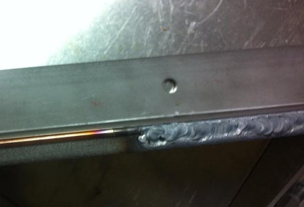

Step 2: Getting a Fat Lip
I decided I needed a lip on the edge, or stands might slide off unexpectedly. Not much of one, but enough to keep things in place.
I started out with one idea, then shifted gears mid-stream. The first idea was to lightly weld a 1/8" TIG filler rod to the edge of the piece, then trim it flush. That didn't look as good as I expected, so Plan B was executed to buildup the edge with a welder, then mill it into a more finished shape. It's not pretty at this stage - it's just supposed to lay down metal to be milled to shape later.

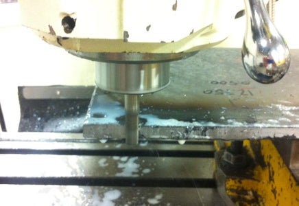

Step 3: As the Mill Turns...
In the milling machine, the front edge was first faced off to be smooth, then the top of the lip was done, and finally the back side of the lip was formed.
Next, part of the profile from a 3/8" radius bit was used to put an arc on the face of the lip.
Then came time to cut the slots. Most of the slots would be 1/2" wide for the stands, with the last slot being 1.1" wide for some sections of PVC I use.
Slots were cut in multiple passes, taking about 1/3 of the thickness each time. I cut the outer slots first because they had the least support.

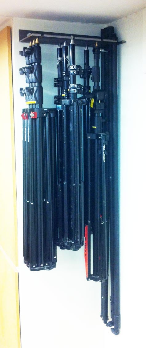

Mounting was done using 3/8"x1.5" machine bolts with washers and nuts on the back-side of a 3/4" plywood cabinet panel. I'd decided where I was going to hang the bracket before I built it, and the dimensions were made to suit.
Had I instead mounted this on a section of drywall, I would have first scouted the location of studs, made the bracket wide enough to span two of them, punched the holes to align with the studs, and used 3/8" lag bolts about 3" long. There's no point mounting something this heavy in just drywall - you'll just end up with a big hole.
Once mounted, this thing was rock-solid. Even loading 8 light stands didn't make it flex. And that's a wrap!
