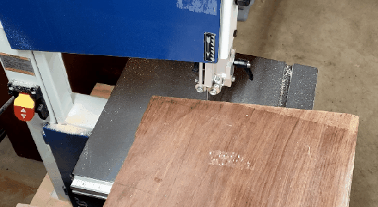

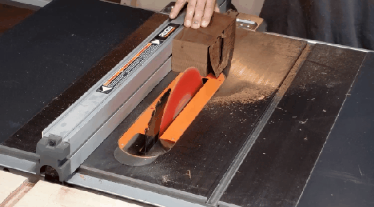

The block of wood to use for the stock needs to be EXACTLY 2.75"x2.75", and approximately 5.25" tall (depending on the model). I cut the chunk out slightly large with the bandsaw, then used the table saw to trim it to the exact size.

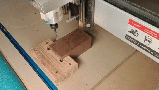

Step 3: Carving a Registration Block
A registration block is anything fixed to the cnc bed that forces your workpiece to sit in a precise position. To ensure that my block locks the corner of our stock at the precise X and Y zero of the cnc, I will use the software to cut a slot exactly 2.75" across.
In Fusion, I created the block around the base of the model laying down. Then I defined the origin as the bottom corner of the base (<-- super important point here!), and set up a pocket toolpath to carve it out.
On the cnc, I screwed down a chunk of 2x4. After running the toolpath, the walnut stock fits perfectly and will be in the exact same position regardless of which side is facing up.

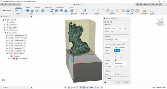

Step 5: The Secret Sauce
Awesome! So let's get Groot out of this block. Now the only way to get to Groot is to carve him from all four sides. How we gonna do that? Great question! Pay attention, this is how we make the secret sauce!
We're going to create 4 new setups and rotate the orientation of the model 90 degrees each time.
Setup 1, with the right side of his face facing up. The bottom left corner of the base is the origin. It gets carved, obviously, from the top down.
For setup 2, rotate the model 90 degrees counter clockwise. Pick a vertical edge for Z and the new bottom left corner for origin, and carve the left side of his face.
Setup 3, rotate the model 90 degrees again. Pick a vertical edge for z, the new bottom left corner for origin, and carve his left shoulder.
Setup 4, rotate the model 90 degrees again. Pick new z line and bottom left corner for origin, and carve his right shoulder.
Because the X,Y, and Z NEVER CHANGE on the cnc, and the stock is ALWAYS in the EXACT place the carves will meet flawlessly around the model. That's the trick!

Step 7: Workholding
Workholding is about making sure that your stock stays exactly where you need it while carving. There are a handful of ways this can be done. You could use clamps to keep it stable in the registration block if you wanted. I chose to drill two 3" screws through the registration block and into the model base. It does leave 8 holes in the bottom of your model base, but hey who cares it's the bottom. Just set a depth flag on your drill bit so you don't poke out the top of the base.
Step 8: Carving!
Run the four roughing paths, turning the stock 90° counter-clockwise between each.

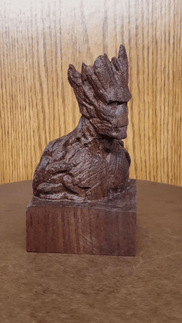

After carving the details on all four sides, we're done! Or are we?

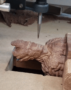

Step 11: What About the Top?
We have a model that looks great from all four sides. However, there are some areas on the top that it couldn't get to from the sides. So, let's see if we can carve it from the top too!

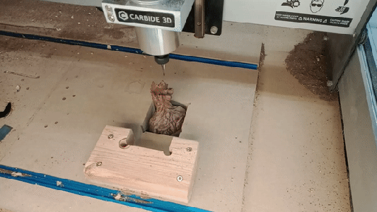

The first obvious problem is clearance height. It was a problem with the model laying down, and it's almost twice as tall. Well up isn't an option, so I'm going to go down. I'm already through the spoilboard, so it's time to cut a small square out of the cnc base which is just a sheet of 3/4" mdf.

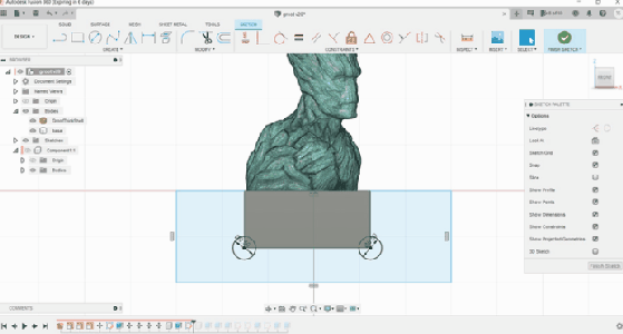

Step 12: Adding (more) Clearance
Back in Fusion, and we're going to start with the model in carving position.
I made a sketch on the underside of the base, which is the same plane as the top of the base board.
I made a big rectangle to represent an area of the base board, and a 2.75" square exactly 2.5" up from the origin.
Then extruded the board down 3/4" leaving the square as a hole.
I made a new Setup using the model base for the origin and the baseboard as the model.
In that Setup I made a 2d pocket toolpath for the 1/4" endmill.
The square hole is the pocket selection, Heights from stock top to stock bottom, and multiple depths.
Ok, fire that off! And now I have a square hole in my cnc!

Step 14: Finishing the Wooden Crown
I made a new Setup, using the new corner as the origin.
I created a 3d adaptive toolpath for the tapered ballnose bit.
Rest machining from previous steps, Heights from the model top to the model top minus 1", and the same settings as the other detail paths.

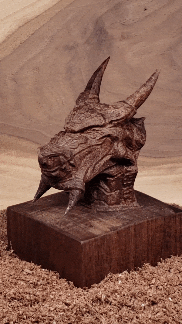

Hey don't stop with one, this works with most detailed models! Most of them won't need to be carved from the top, unless they are indented like Groot. Albert's hair needed some top-down detail, but the dragon and Frank didn't.
