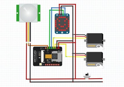

ESP32-cam (with FTDI)
Pan & Tilt kit
2x SG90 servo motors
PIR sensor
LED matrix 8x8 (green)
switch
box

Step 1: The Electronics: ESP32-cam
The ESP32-cam does not have a USB launch. For the upload, I recommend an adapter, but you can also do it yourself with an FTDI adapter and a breadboard.
A face recognition program is integrated in the ES32-sketch. Among everything the camera sees, the shape "face" is recognised and imaginarily surrounded with a frame. It does not recognise your face, but a face
If this frame is in the middle of the picture and WatchEye is looking straight ahead, everything is fine.
If the frame is e.g. on the right side WatchEye is moving to the right until the frame is in the center again.
For the image size I use VGA in the sketch. You can also try SVGA, but the image processing will then be quite slow.

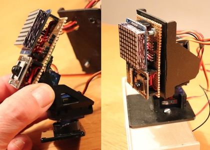

Step 3: Pan & Tilt & Servos
I built a pan&tilt device myself in 2020 from plastic sheets. But a pan&tilt kit is easier to handle and not expensive. It can hold the weight of the PCB, ESP32 and LED matrix.
Step 4: Electronics: PIR Sensor
Our pet should sleep and save power when we are not there. As soon as someone enters the room, WatchEye wakes up from a deep sleep and turns his eye to the visitor. The eye follows our movements.

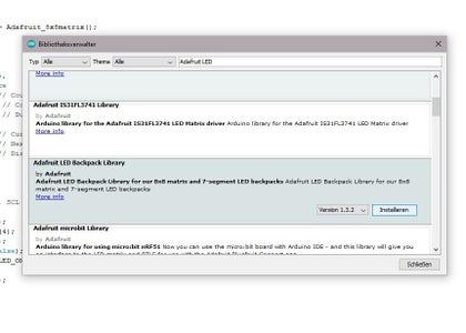

Download the three files and put them all to one folder. Then open WatchEye.ino file with Arduino IDE. Include some Libraries:
Sketch --> Include Libraries --> Manage Libaries
Enter "Adafruit LED" and install "Adafruit LED Backpack Library" and depending libraries.
Send the sketch via USB and a COM port to the ESP32-cam.
Step 6: Putting All Together
Now it is up to you to put everything together. I soldered a board with ESP32-cam, LED matrix and connections for the servos. The board is attached to the pan&tilt mechanism.
