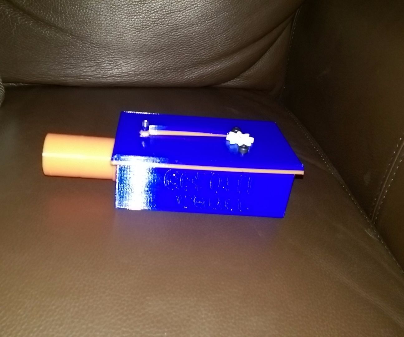

After our washing machine ruined our Kitchen floors I decided to see if I could make an alarm to detect the water.
Step 1: Redback
Started with this little wifi arduino device. It is sold by Linksprite.com I was able to get a good deal on one from Ebay.
You can use a wifi shield or any wifi board that will work on Arduino.
I did struggle for a while getting the Redback to work at all as the documentation is non existent. They provide a few tutorial/examples but no real docs for the code.
Wired up an LED on pin 9 as that's the one that the Redback uses to show it's online, then a red led on analog pin 2 but using in the code as a digital pin.
This sensor has digital and analog outputs. I'm only using the digital.
Basically we get logged into router, then wait till the water sensor is HIGH and then go into a loop where we send the email to a PHP page on my server that will send the text message.
The PHP code is pretty simple I used a "magic number" as a security measure. The PHP will not send email without the proper number. This litte trick lets you send SMS message via ATT you sould be able to do the same for any wireless carrier
