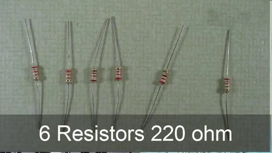

Step 1: Things You Need...
4 - bc548
6 - 220 ohm resistors
3 - colour led
1 - buzzer
1 - 9v battery + battery clip
