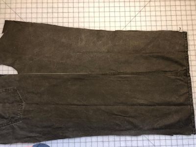

Step 1: Prepare the Fabric
  • Cut off hems of pants
  • Cut along outside seam to the top of the pant leg, towards the zipper, around the crotch and up the 'seat' seam, just below the waistband back towards the other side of the outside seam. You should now have one large piece of fabric. The remaining carcass - which we won't use - will have the zipper, the waistband and the one outside seam (see photo).
  • Cut out the second pant leg in the same way. The remaining 'carcass' - which we won't use - will have the zipper, the waistband and the one outside seam (See photo A).

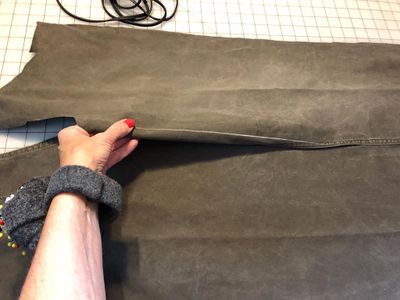

  • Take one piece and remove the crotch seam about ½ way down (See photo B). When you have removed enough seam, lay one side down so its smooth.
  • Lay the other side of the opened seam across it. Lay a yardstick along the seam that is already there and mark it with chalk. At this chalk line, fold the top layer of fabric in to meet the seam line you marked.
  • Now stitch this seam from end to end 1/8 from fold. To give the seam a little more 'meat' stitch again 1/8" next to the stitch line you just made. Press all fabric real good.
  • Now you want to make a rectangle from each leg. One leg will be the outer bag fabric, one leg will be the lining of the bag.
  • First, see what the longest length you can get from your new piece. Mark vertically on each end and cut off. Measure this length you got. Now divide that number by 3 and this will be your height. I got a 30” long piece, so 10” is going to be my height.
  • I marked 6” on one side of the center seam, and 4” on the other side of the center seam. This gives you a cool extra seam character on your bag – you will see it on the finished bag later.
  • Repeat this for the other leg of fabric so you have 2 pieces of fabric the exact same size.

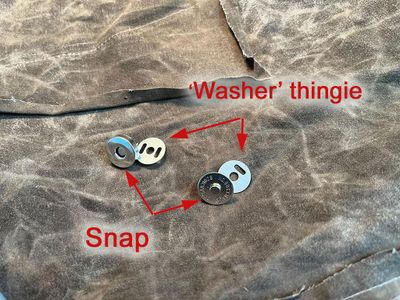

Step 4: Attaching the Snap to Lining
I am always looking for old purses or bags, that I can tear apart, saving the rings, snaps, zippers, buckles or other closures. You can get a lot off of one bag! I got the snaps and rectangle rings for this bag from old discarded purses. This snap is attached to the inside of the bag on the lining piece.
  • Turn the lining so the right sides are together on the inside of the bag.
  • Decide where to put your snap on one side of the bag – 3/4” from edge of bag V.
  • Take the washer part with the holes, lay it in place on the right side of the fabric and mark with a pen the two holes.
  • With a seam ripper, poke into the fabric thru the flap and cut a little slit for both marks.
  • Take the male side of your magnet and push the prongs through the 2 holes.
  • When through lay your washer part over the protruding prongs, and then press down the prongs towards each other nice a flat, using a screwdriver.
  • Lay your purse down nice and flat making sure everything is lining up.
  • Now push the snap you just inserted into the other side of the bag, rubbing a bit and it will make a little mark exactly where the other snap needs to go.
  • Align your washer center circle with the mark you made - then mark the two open sides with a pen.
  • Repeat the steps above to attach this side of the magnet.
  • Now the snap should snap and line up nicely.
