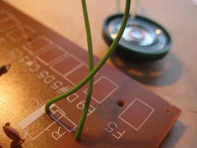

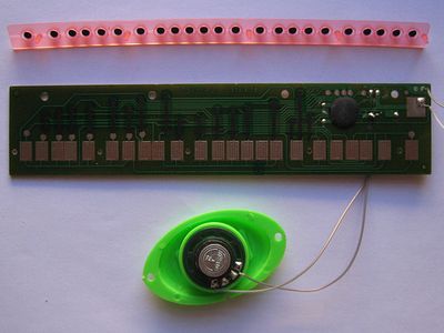

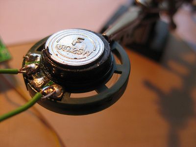

Step 2: Hack the Piano
- Open up
- Take everything apart, strip down to the bare circuit
- Take photos and notes, document the process

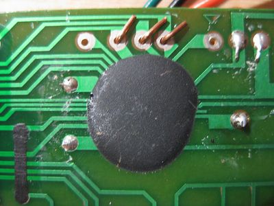

Step 3: Understand the Circuit
- Exchange wires for more flexible ones
- Experiment with connections and find out where power, ground, input and outputs are
- Identify components
- Use your notes to analyze the circuit and draw a circuit diagram
- Power source: 2 x 1.5V battery (see: Fabric Battery Pouch)
- 23 keys using 11 microcontroller connections (different combinations of the first 3 and the last 8)
- One 470 K Ohm resistor (can be exchanged for a variable resistor to manipulate sound output)
- No on/off power switch, but this can be created
- Two connections that go to loudspeaker
Step 4: Prapare Your Circuit
Minimize your circuit, take all extra material away, see how small you can get it and then decide on interfacing method between t-shirt and circuit:
How the circuit works after being hacked >>
- poppers
- hooks and loops
- conductive Velcro
- fixed connection
- metal magnets

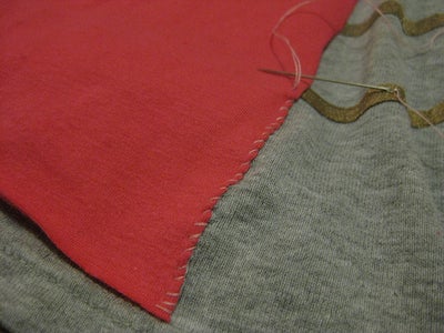

- Sewing with conductive thread

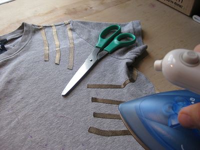

- Fusing conductive traces to fabric with fusible interfacing
- Stretchy conductive trace: using stretch conductive fabric and fusible interfacing
- Isolating stretch conductive traces with stretchy fabric glue

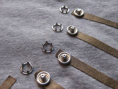

- Soldering loops to connect between poppers or to sew with conductive thread
- Forming Shapelock to embed components and make them sewable
Step 6: Detachable Interface
Your interface between the circuit board does not need to be made with poppers, but in this example it is.
Step 7: Fabric Conductive Traces

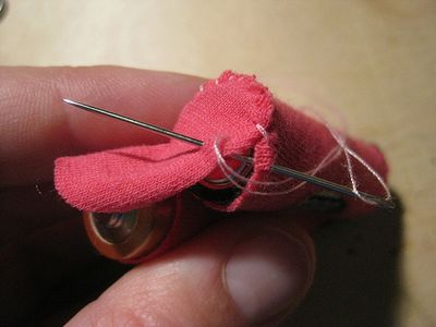

Step 10: Fabric Power Supply
See: Fabric Battery Pouch
