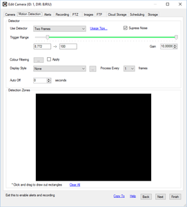

- Motion Detection Tab : here let's change the trigger range, let's say it's the sensitivity of your detector mine is on the range 10->100, maybe you'll have to make a few try to find the range corresponding to your environment in order to avoid false detection...
