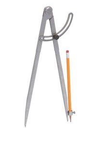

This step will require a compass large enough to make a circle with a radius of 10 inches. Harbor Freight sells a large 12-inch compass, but you can do this with a homemade alternative (Trammels, for instance). I kept a smaller compass handy to help draw the smaller 1 7/8 inch center circle. While not necessary, it kept me from having to adjust and re-adjust the larger compass.
The steps are:
  1. Set your larger compass or trammels to 10 inches. You can use a ruler to help you set this length. This radius will give you a 20-inch diameter cover/guard.
  2. Once set, use the larger compass to draw your cover/guard circles onto the plastic sheeting. Make sure the pointed end opposite the pencil makes a good dent in the plastic so you can find it again with the smaller compass in the next step.
  3. Next, use the smaller compass to draw the 1 7/8 inch center circle. This circle will be punched out later. The resulting hole with fit over the bearing housing in wheel's center.

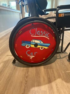

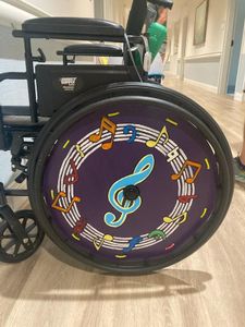

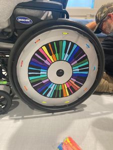

We used acrylic paint and paint brushes to add color to the designs. We found outlining in black made the design "pop". This part of the process is perfect for a group.

We used a clear spray enamel (gloss) to protect the painted cover/guards from contact damage.
Three cans of clear enamel were enough for all 50 guard/covers in our project.
Step 9: Installing Your Cover/Guards
We found these colorful zip ties at Walmart.
Simply place the cover/guard over your wheel and zip tie it to the wheel's spokes.
Tip: After each zip tie is secured, push the bulky end to one side. This will prevent any possible interference with the wheel.
Finally, use scissors to trim the excess length from each zip tie.
