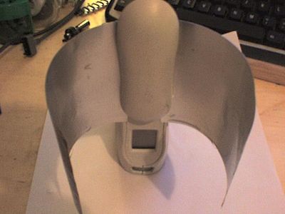

This is a simple device anyone can make, that should improve your reception quality and or strength.
An aluminium can is the basis for the design, therefore making this a very affordable project to try in your spare time... Goodluck!! :)

1. Cut top and bottom off can.
2. Slice up one side.
3. Expand to relavent angle, close to 100mm diameter. The can starts at approx 65mm.
4. Cut an appropriate section out of the bottom edge to suit your antenna.
5. Add some tape to edges if desired..

Due to the individual characteristics of your WiFi antenna, you will need to tune you "dish".
This involves fixing it behind your antenna, then expanding and contracting the "gap at the front of the "dish".
If you have applications on you computer on signal and or strength, use them.
Apply the same rules as finding a suitable location for the modem. Take note of where the diameter of the can is giving the highest results.
Once you have noted this, remove the can and shape it to remain in that diameter... My sweet spot is an opening of 110mm and would be a good place to start, when tuning yours..

Step 6: So.... Did It Do Anything??
If your not getting a responce, try moving your "dishs" direction to point elsewhere...
If it doesn't work within an hour of fiddling... it probably means you antenna wont' respond to the dish behind it. Try going free-style and hold the dish in your hand around, to the side, infront, above, below the antenna etc... the reflections may assist reception too...
Goodluck and I hope this brings you as much happiness as mine has...
Yay no more "red" signal and only green now!! ;)
