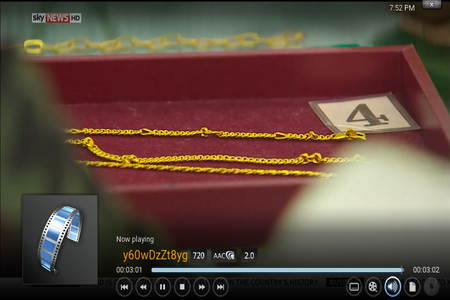

Step 5: Change Audio Output (at Kodi)
We need to tell kodi to start sending audio to the loop device instead of HDMI/Analog as we created during plumbing.
Go to kodi home or main screen.
Goto SYSTEM -> settings
Goto System
Goto Audio output
Click on Audio output device -> select ALSA: Loopback (loopout), Loopback PCM
Exit back to home and then try to play a stream, there should be no sound from HDMI/Analog.

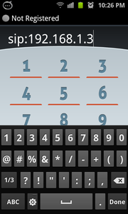

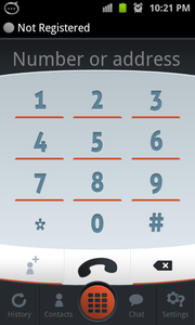

Step 6: Install Linphone App (on Smartphone)
We are going to install free Linphone App on Android and call our linphone daemon on xbian to listen to live audio of the stream playing on kodi.
Install Linphone app from Google Playstore. (I think there is an iOS version available to Apple users).
We are going to place a direct call between the app and the daemon running on rPi/xbian or the kodi machine. Lets assume it has IP address 192.168.1.3
Launch the app. Don't create an account if it asks to. we don't need to login to any VOIP server. The app should show Not registered on left top corner.
Now, tap on Number or address field of the app and type sip:192.168.1.3 and press call button on the app.
The app should now get connected and you should hear the audio of the kodi stream. It might be low, so you would have to bring the phone near your ear to hear it. You could tap on the speaker icon on the app to activate speaker phone and it should be louder. You could also connect earbuds for private listening.

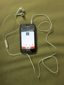

Step 7: Tips
Voice out of sync with video?
This setup like any other network based streaming might introduce some delay making audio & video a bit out of sync. Fortunately, kodi has an Audio offset setting that if set to ~ 0.200s will make video & audio in sync again.
Echo?
Keeping the mic on the App muted will avoid hearing yourself or other noises.
