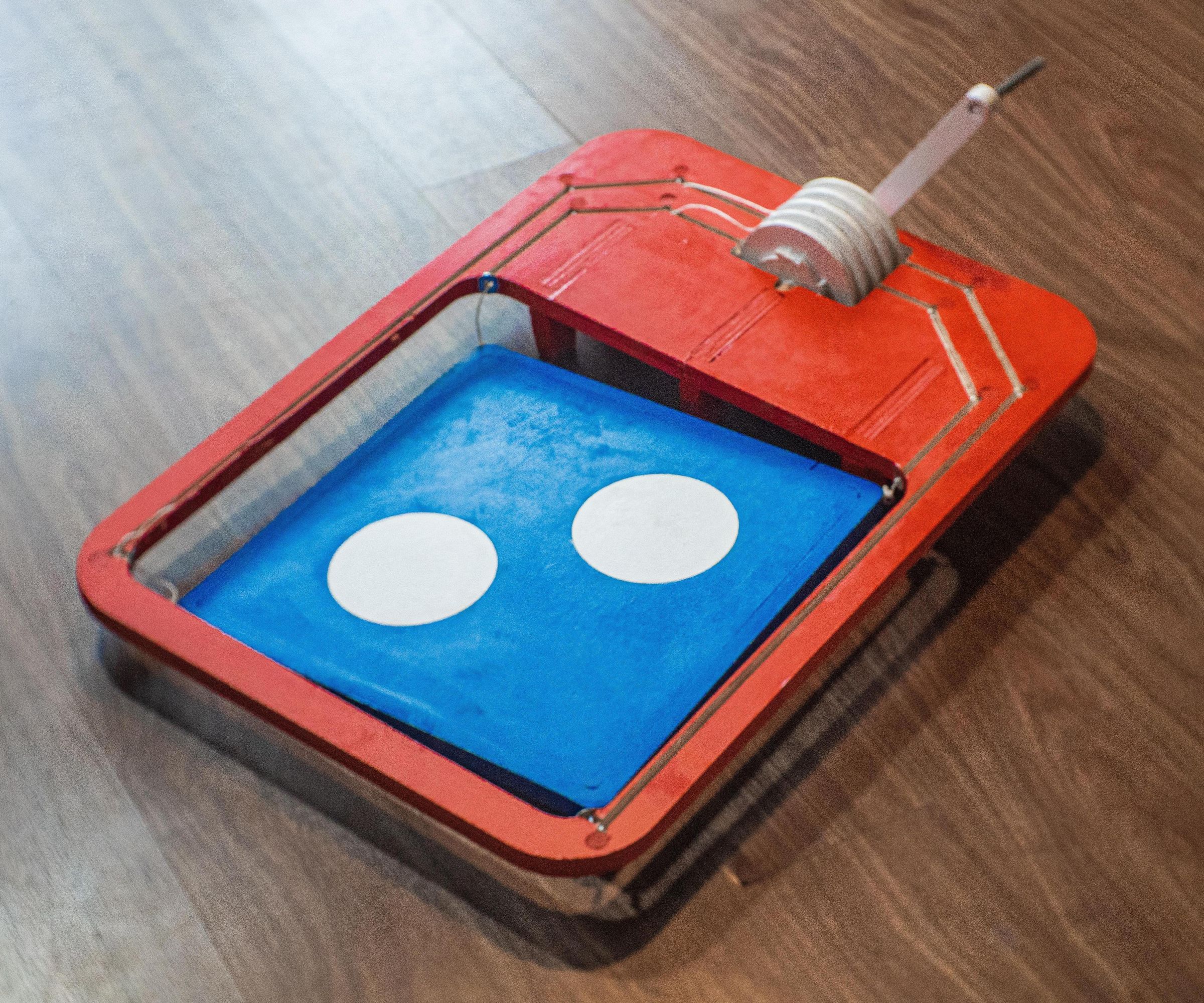

Step 1: Print the Parts
Print the parts! The only parts that need support are:
"LensBody" and "Mount".
Pictured the layout on my Bambulab P1P ^^
