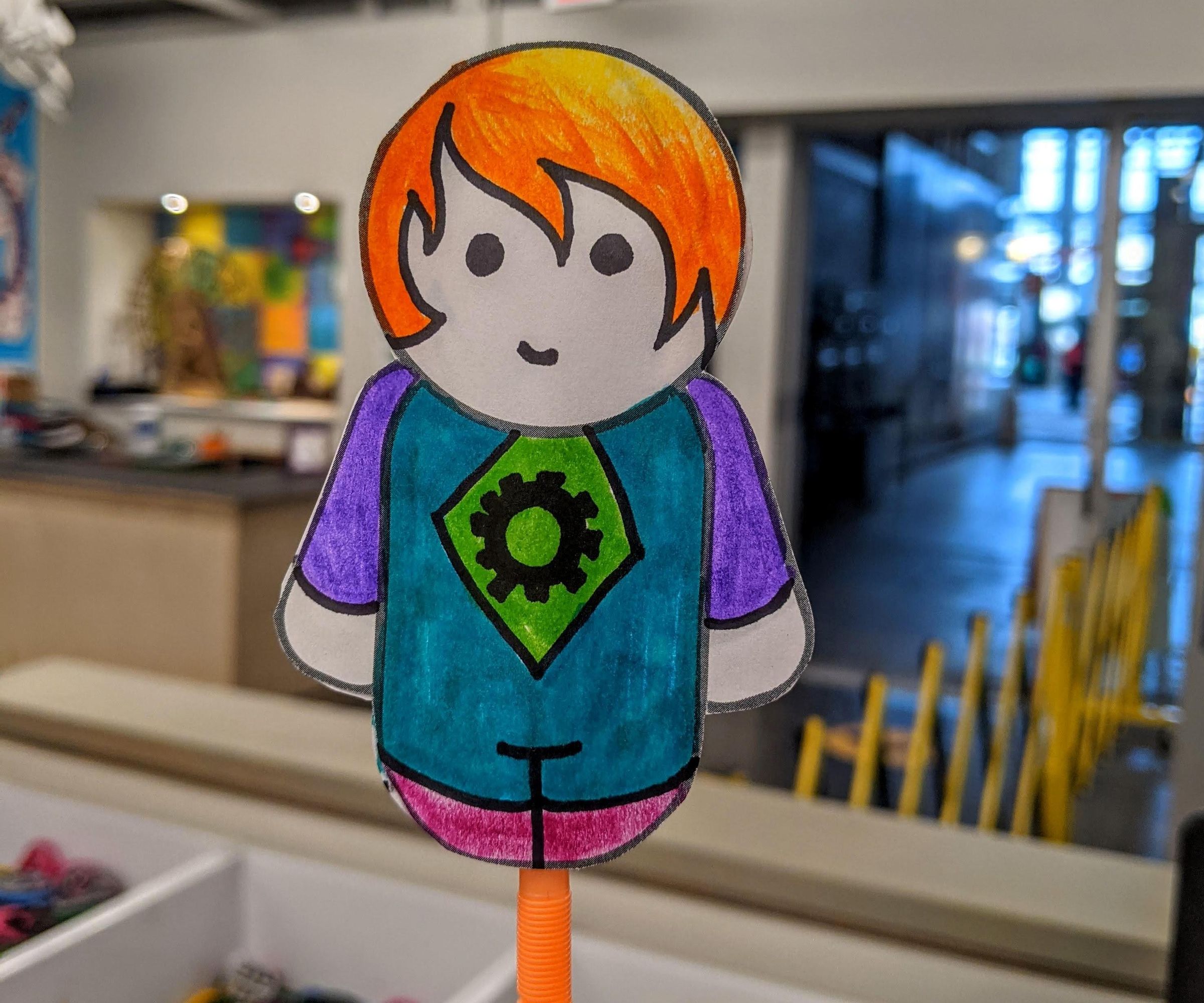

Step 2: Make Your Robot!
Make your robot (or other fun thing) that will wiggle and wobble when you're done. Make sure it ends up around the size of a 3x5 note card. (We used metallic cardstock, metallic sharpies and silver pipe cleaners.

Step 10: Add Skewer Segment to Robot
Place skewer into vertical straw to make sure it’s long enough, it should stick out at least 1/4 “. Glue/tape robot onto part of skewer that is sticking out.
Step 11: DANCE ROBOT DANCE!
Turn cam, robot will wiggle and wobble!
