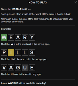

If you read this Instructables, I guess that you probably already know what Wordle is... If not, Wordle is an online word game, with a new puzzle every day. You have 6 chances to find a five-letter word, in English. After your guess, the color of each letter indicates whether it is well placed (green), it exists but in another spot (yellow) or it is not in the word (grey).

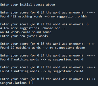

Then run the python script. It first asks for the word you just tried. Then it asks for the score, meaning the answer from Wordle. As the answer is colored, I used the same convention as in my other Instructables:
- + for a letter that is correctly placed (green)
- = for a misplaced letter (yellow)
- - for a letter that is not in the target word (grey)
For example, if the answer was : green yellow grey grey green, you just need to type +=--+
Be careful, as there is no verification. My code does not verify that you typed a 5-letters word or 5 characters for the answer.
Next, just follow the instructions from the code. If everything goes well, the code suggests a new word for you to play. Type it in Wordle, and then enter Wordle's answer, and so on until you win...
If the suggested word is not recognized by Wordle, then type 0 as the answer: the code will provide more suggestions. Choose one of them, type it both in Wordle and in the code, and continue as before.

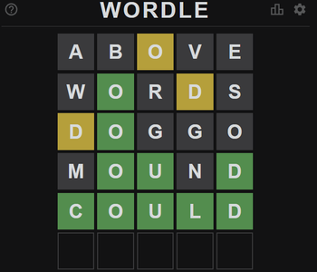

Here is an example from today (Jan. 29, 2022):
- First guess is above (the word 'above')
- Wordle's answer: grey grey yellow grey grey, which is translated to --=--
- Suggestion: ohhhh
- This word is not recognized by Wordle
- Input 0
- More suggestions: would words could sound found
- I choose words
- Wordle's answer: -+-=-
- Suggestion: doggo
- Answer: =+---
- Suggestion: mound
- Answer: -++-+
- Suggestion: could
- Found it! Answer is +++++
See the images for a more graphical explanation.
You can see that 'could' was one the suggestions of the code, when 'ohhhh' was not recognized: I could have won in 2 guesses!!

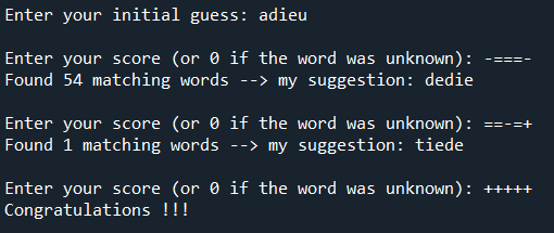

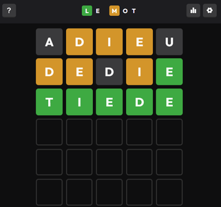

Step 3: A New Win in French
And here is a win in 3 guesses for the French version of the game.
