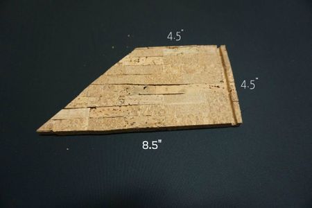

For this design, the sizes of each board is:
  • 8.5" by 4.5"(The base)
  • parallel sides of the trapezoid: 8.5" and 4.5", height 4.5" (two trapezoids)
  • 3.5" by 3.5"(the top of the box)
  • 4" by 3.5" (the cover of the box)
  • 3.5" by 5.5"(the side that is going to fit the light bulb and wire)
Note:
- Sand a 45 degree angle on one side of the base. (As suggested on the picture)
- Sand a 45 degree angle on both sides of the board that is going to fit the bulb.
- Slightly sand one surface of the cover board to make that surface tilt.
For the two trapezoids, I used an x-acto knife to cut a 1/8 wide line into the board and I glued two wood pieces on to the cover of the box so they can slide over each other.
