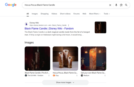

Research is always vital when attempting to create recreate any prop wether its from a film, tv show or game.
I could find 100s of spooky candles or Halloween candles, but not many of the actual candle that I wanted to replicate.
It wasn’t until I actually used the family Disney plus I realised that the candle was sufficiently different than I remembered.
I ended up taking a few things I liked from a few sources and amalgamating them into my own.

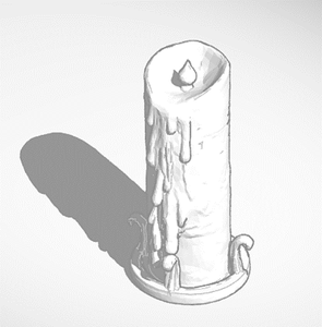

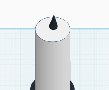

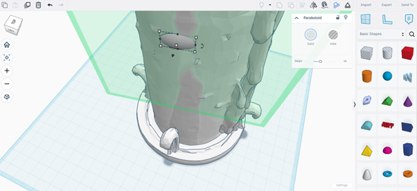

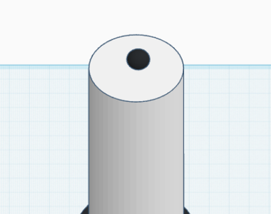

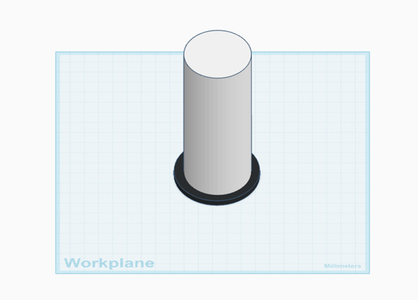

Using some of the best pictures I could find for reference I took on creating my design, using Tinkercad a free online designer which I used to slowly built up the basic shape of my design.

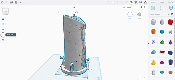

Step 3: Building Your 3D Model

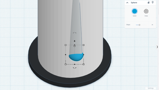

When I was happy wit the general look, size and dimensions I took to adding the details, marks, running wax, the base and so on.
This took a lot of time to add each piece but it was worth it, as each additions I could see the design coming to life.
Step 4: Finishing Touches
After a few days of editing, and making adjustments which is a lot of trial and error I saved the final design for the last time.

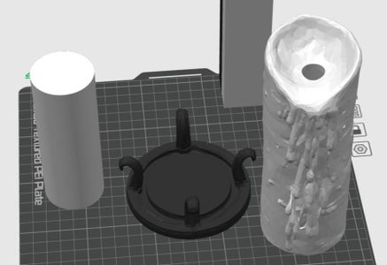

Printing was simple, I downloaded my STL file from Tinkercad to my laptop, the used Cura to scale the candle to a height of 240mm (24cms),
I felt this gave it roughly the correct height for an stand out piece along with my other Halloween decorations. I added a 30% infill to ensure that the print was sturdy with a bit of weight to it. I sliced the file, saved it to my SD card then took it to my printer.

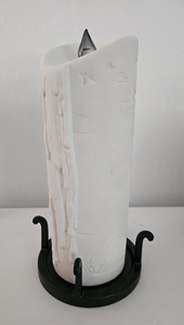

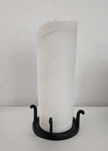

Now Painting, my 3D printer only prints in one colour, others do 2 or more so you can just print the base black straight away, but as I cant do that I masked off the candle part with masking tape and part of a newspaper and just sprayed the base with 3 coats of primer, and once dry 3 coats of Matt black car spray paint which isn't expensive at all only a few pounds and you will have loads left over for more projects.
NOTE; When masking off and painting areas with delicate parts be careful not to break off any parts, they will glue back on but it will set you back timewise!
For the wick, I was tempted to colour it green or something, but black seemed more sutable and closer to my original design. I masked off the top and got out my trusty airbrush set, as I find it gives a better finish, but you can just use the spray can if you want.
I watered down my paint so it was super thin, and then gradually started at the top darker and less at the bottom giving a flickering effect, when I was happy I added a clear lacquer and give it a good 3 coats to really give it a shine like it was lit and so it would reflect the light.
You can paint your which ever colour you want, I may even do another but with a black candle, and a brass looking base, and a green flame, who knows.
Step 7: The Finished Result
The finished result of a clean fresh looking candle that really looks great, I am so happy with it, I will at some point be adding some of the markings I located online, but for now I am happy with it......and also I have already started making 'BOOK' which is another instruct able to come shortly.
