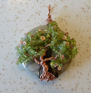

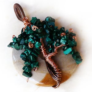

This tutorial will teach you how to make the ultimate wire wrapped tree. It features natural gemstones with a large jasper donut serving as the canvass for realistic wire roots and branches. The branches are accented with beautiful peridot or malachite foliage. Once you learn the techniques for making these gorgeous trees, the combinations of metals, gemstones and finishes are endless. This tutorial will show you how to make a fabulous pendant as well as slight variations for tree earrings and tree bracelets!

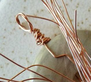

Step 6: Wrapped Loop for the Bail
You will make a large wrapped loop for the bail. Below are the instructions for a basic wrapped loop. The bail (which is larger) will be the same as the photos except for the following adjustments:
You'll be using twisted wires
The loop needs to be large enough for a cord or chain
Bend the twisted bail wires at a right angle, 4 - 6mm above the top of the donut. Use flat nose pliers.
With round nose pliers, hold the wire at the bend and loop the wire (tail) over the the WIDEST part the pliers and into a circle using your fingers. (Or use bail making pliers for this if you have them.) Adjust the loop shape with the pliers and complete the loop into a perfect circle.
Then wrap the remaining wire tail around the straight part of the wire in the space left above the donut. Make at least 3 full wraps. You can wrap as much as you want after that if the wire is long enough. Cut excess wire if you want. (Though I usually leave the excess until I know what's happening with my design.)

Step 13: Finished!
When you're done, make sure to tuck any loose ends out of the way. Under a branch is good.
Feel the pendant with your fingers for rough spots and then rub the front and back on a piece of fabric. If you find any sharp spots or wires that catch; file, trim or tuck in the problem wires until everything is perfectly smooth.
Now you can add a patina, buff and/or seal your pendant if you want. When any finishes you’ve added are dry, your pendant is ready for a cord or chain.
Have fun!
Step 14: Variations
Once you have the basic technique down, the variations are endless. Here are some ideas to try:
Use other gemstones, beads or crystals.
Use other gemstone shapes for the base.
Coil wire around the bail.
Make a wire ring for the base.
Make other sized trees with smaller donuts. And turn a set into tiny tree earrings.
Use the tree to make a focal for a bracelet by adding a second wrapped loop. Use the two loops and 21g round wire to attach the tree to a metal or leather bracelet base. Or make your own bracelet base and wire the tree directly onto it.
