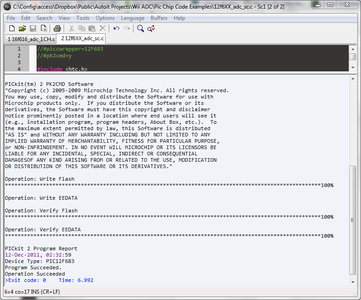

Step 4: Programming the Pic Chip
As mentioned in the intro, the .zip file contains a custom Scite Editor with options to compile and program the pic chip. Use the file ScitePIC Startup.exe to launch the editor. This small startup app is important as it makes sure this standalone editor does not interfere with the other scite version (for autoit) installed.
To use the compile and program options is very simple. If you want it compile your pic program place the comment //picwrapper= and whatever chip you are using somewhere in the script. To have it program your chip, add comment //pk2cmd=y somewhere in your code.
Ex: //picwrapper=12F683
//pk2cmd=y
Both options are already written in all the code examples, just make sure the chip is the one you're using. Open what ever example you are going to do and Press F7 or select Build under the Tools menu. This will compile the example and program the chip.

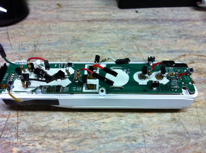

Step 5: Soldering Connections
Each button on the wiimote is a simple push button that when pressed, creates a path between two pads allowing the current to flow. The current travels out of one pad and in to the other. We need to figure out which pad is out and which is in . To do this, use your volt meter to measure the voltage on each pad. One side should be about 3v, the other will be very, very low, but not 0v. 0v is ground and none of the button pads go to ground.
The collector pin will go to the high voltage pad and the emitter pin to the other. The Base pin connects to the 470k resistor that then goes to the pic chip. How you wire it up is up to you. I find that while it might look a little sloppy, soldering the transistors and resistors straight to the wiimote lets your bread board have way less wires going on and helps keep the wiring very clear. And way less moving wires around if you try doing it with different Pic chips. Doing it this way Pin “*” goes straight to Button “*”. Simple.
