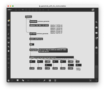

Step 5: Test in Max
- Power on the device with the switch. Note that you can charge the LiPo directly from the board.
- Use the included Max/MSP patch to receive the data.
- instructables does not allow uploading .maxpat so instead the json is provided. Please copy the contents of the text file and in Max click - File->New From Clipboard
- the patch uses sadam.udp so you will need to install this package
- Confirm that motion and keypad inputs are being transmitted correctly.
