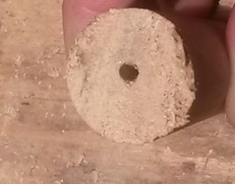

Step 2: Drill the Dowel's Ends for a Wire
Make sure that the wire can go all the way through.
