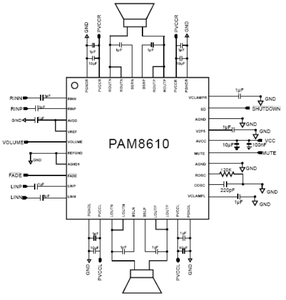

Step 1: Connecting the Power
  • Locate the VCC (Voltage Common Collector) and GND (Ground) pins on the PAM8610 module.
  • Connect the positive (red) wire from your power supply to the VCC pin.
  • Connect the negative (black) wire from your power supply to the GND pin.
  • Ensure that the supplied voltage falls within the recommended range of 7V to 15V.
More about PAM8610 pinout details view here.
Step 2: Connecting the Audio Source
  • Find the input pins designated for the left (L) and right (R) audio channels on the PAM8610 module.
  • Connect the left channel of your audio source to the L+ and L- pins.
  • Connect the right channel of your audio source to the R+ and R- pins.
  • Ensure the connections are secure and snug.

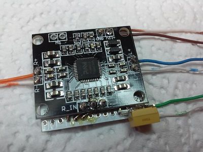

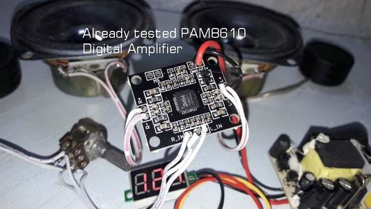

Step 3: Speaker Wiring
  • Identify the speaker outputs on the PAM8610 module.
  • Connect the positive speaker wire (usually red or marked with a "+" symbol) to the L+ and R+ pins.
  • Connect the negative speaker wire (usually black or marked with a "-" symbol) to the L- and R- pins.
Step 4: Grounding
If you encounter any unwanted noise or interference, consider grounding the amplifier's GND to the common ground of your audio system.
This comprehensive guide ensures that you harness the full potential of your PAM8610 amplifier, delivering exceptional audio performance for your projects.
