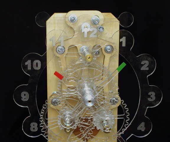

Step 8: Completed Mechanical Clock
This is a massive piece of hardware. I like clocks and have built numerous types from fully electronic LED models that look like analog clocks to 6-foot grandfather clocks. However, visitors to the house are always drawn to this one.
The hands were originally made from a light-colored wood but I ended up using three paints which makes it easier to read the time. Watch the short video to see the gears and hands in motion. I also have a 12-hour version so could see all gears rotate at least once. Just kidding.

Step 18: Code Improvements
While running the clock, I was not pleased with how the time set and hand set buttons worked. The pushbuttons were queried within the Arduino main loop which did not always catch the button press.
So, here is the new method: The RTC clock does not require to be adjusted often. An exception is when we switch from standard to daylight saving time and vice versa.
Synchronizing the hands to the electronic clock is another story. This needs to be done evert time the clock is powered up or re-powered up after power failure.
Therefore, the Arduino code works as follows:
When the system starts up the Setup section stops in an infinite loop. One pushbutton can advance or retard the RTC clock by one hour (useful for time switching). A second buttons does the same for the seconds in a faster way. Once you are satisfied with the setting, a third button escapes from this loop and enters a second loop.
There, one button advances sort of a cursor to the place where one advances the number of hours, minutes and seconds to the actual position of the hands. Tip: Manually set the second hand to the 12 0'clock position first so you do not have to bother with seconds. A second button advances the number of hours, minutes and seconds. Once this is done, a third button escapes from this loop and drives the hands at high speed until they are synchronized with the RTC clock. The, the setup section is done and the regular code loop is entered. There was another reason to make changes. See next step.
Step 19: Sound
The original design included a tick-tock sound every second implanted with brute force by the Arduino code and a small piezo speaker. What about sound at the quarter hours and full hours?
Well, I discovered two things, a sound effects board and sound files on a website of the British Parliament. They were recordings of the classic Westminster chimes and chords.
The Adafruit FX Sound Board is small circuit board that stands alone by itself. It only need 5 V power. It contains a 2MB flash memory where one can place small sound files either in WAV or OGG format. Up to 11 trigger pins are used to play the files. The board not very smart. The files are played according to the names of the files. For the purpose of the clock, files are only triggered to play, not looped and not held. The names of the files, in that case, are Tnn.WAV or Tnn.OGG where nn goes from 00 to 10. So, placing trigger button 3 to ground, plays the T03 file through a mini phone jack (usable only for powered speakers or headphones.
The Arduino's role is limited to triggering pins of the sound board.
I edited the composite sound files from the Internet into files for each quarter hour and into short hour sounds plus one hour sound with a longer fad-out. The first three quarter sound are simply called at the appropriate time.
The sound board can only accommodate 2 MB worth of files. OGG (compressed) files have a noticeable delay before they start playing and I stayed with WAV files. However, in view of the limited space, I converted the files using 11kb PCM mono files. This consumed about 1.2 MB of flash space. The loss of quality cannot be perceived.
Playing the sound at the top of the hour is a bit more complex. First, the 4th quarter sound is played, followed by short hour sound for the hour number less one and finishes up with the hours sound that a longer fade-out.
Files cannot be queued up. One has to wait until a sound is played completely before asking for the next file.
The sound editor provided us with the playing time. One could think that we tell the Arduino play files and delay the next file. That does not work because the code that drives the motor needs to run without delays.
The trick for playing the sequenced sounds at the top of the hour is to play 4th quarter file and set a time marker (as perpetual Unix seconds) 15 seconds in the future. The code then traps that time and plays the first of the short hour sounds and sets another time marker 2 seconds in the future. Using 6'oclock as an example, after playing 5 short hour sounds, the last is the hour sound that has a longer fade-out.
I used a pair of very small computer speakers. Just about all speakers these days are powered by USB, I added a USB on the control box supplying the 5 Volts to the speakers.
The default volume does not rattle the walls but is soft enough to be pleasant.
I did not include the Arduino sketch here. If you want it please ask.
Finally, below is an example of a sound.
