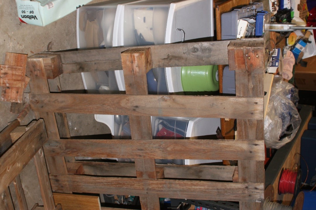

Step 2: Pallet
First step is to choose a pallet, you are going to want one that is hard and looks not too worse for wear. It should also be semi-thick, like 3/4 thick.
It also needs to be heat treated only, it should say HT on the label. If it has other markings, it may not be safe. Check out this ible here for more info.

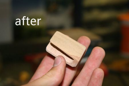

Step 5: Cutting the Cavity
Now for the moment of truth! To cut the clip part! I used a reciprocating saw and a hand saw for this part. I started with the reciprocating saw and sawed down until it almost got to the drilled hole, and then I stopped, and got out my hand saw and just cut it a little more. Now you have a working money clip! It may not be the prettiest [yet] but it works.

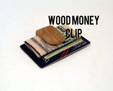

Step 8: Final Result
It turned out amazing. I really like it. I ended up making quite a few and handed them out to a couple of friends... And I also learned that you shouldn't try to overstuff your clip, it can hold quite a bit, but it shouldn't be OVERstuffed.
You could also add a couple of customizations and other things like fancier sanding designs and wood burning.
Also, this works for regular wood, not just pallet wood...
