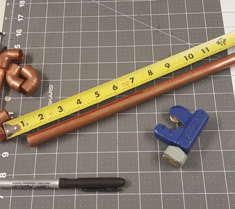

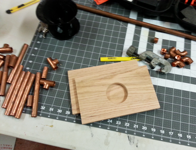

Copper: Using a measuring tape, measure out 6" and mark with a marker. Using the pipe cutter, cut ten - six inch pieces of the copper pipe, then cut eight 1 1/2" pieces of copper pipe. We are through for now with the copper.

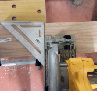

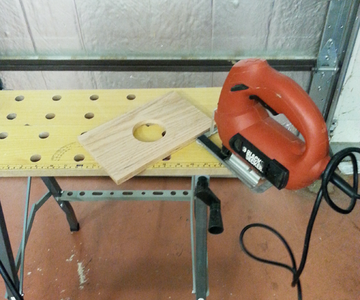

Wood: Using a circular saw, cut the wood down to size. For this project you will need two 9" (L) pieces. (Note. This wood is from the big box store. I purchased a piece of 2' x 6" x 1/2" Red Oak board. Keep in mind that although the tag says it is 6" wide. The actual measurement is 5.5" (W).)

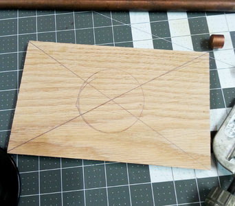

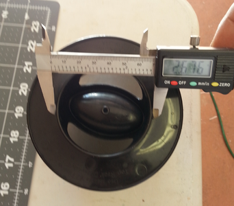

The top board will need a hole for the Melitta Pour Over Coffee Maker to sit in. Using a measuring tape, find the diameter of the bottom of the pour over coffee maker. (I am using digital calipers here to get the measurement).After finding and marking the center of the board, use a jigsaw to cut out the hole.

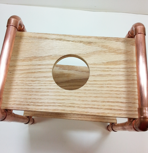

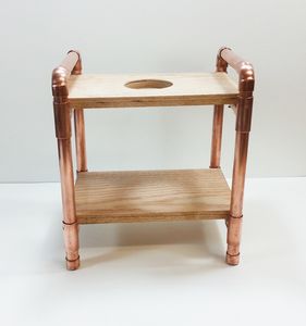

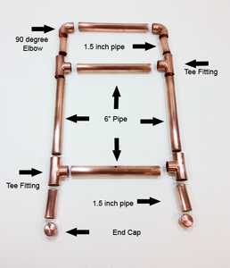

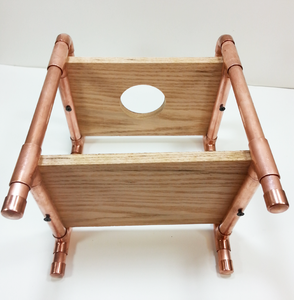

An exploded view of how the pieces should be attached is shown. Simply dab a drop of glue on each part, then push together and hold for a few seconds ensuring a tight bond. This is what I will call the coffee stand leg . You will make two legs. (See photo)

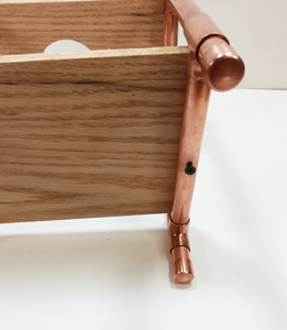

Next, we will add the two boards, which will effectively tie the entire project together. To secure the boards to the copper legs, use a screw to screw through the copper into the oak boards. Your Project is now complete.
Step 4: The Final Project

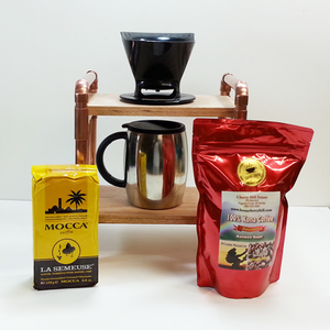

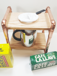

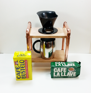

This coffee stand was made specifically for the Melitta pour over coffee maker, but can be adapted for any brand pour over maker. This can also be used with a bolsita or bolsa bag. This bag has many names in several places around the world, but it is essentially a piece of cheese cloth that holds the coffee while brewing.
