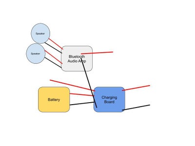

Step 1: Solder the Circuit
We start by soldering the majority of the circuit. Connect the battery to the charger then connect wires to the four corners of the charging component, but only connect the OUT- wire to the Bluetooth audio amplifier's GND port. Then wire your two 5 volt drivers to the audio amplifier's L&R ports respectively. Lastly, attach a red wire coming out of the 5V port on the Bluetooth component which you'll attach to the switch later
Step 2: Test the Components
With the components connected like this, the speakers should be fully functioning while the battery is connected. You should test it not by connecting a device and playing some tunes. We assembled a simple prototype boombox for the acoustic effect and some style points.
