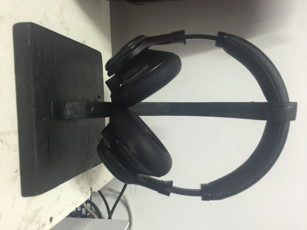

ErwanJez
ErwanJez
8 years ago
Works great! I just mount the stand on a wooden box to store my helmet's wires. Paint dit on black with stainless screws ... And voilà !
