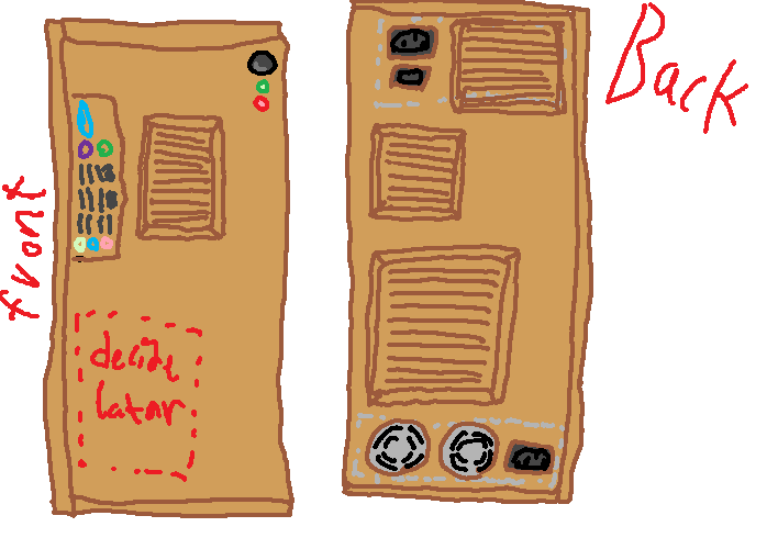

I have had my own plans for something like this for a few months now... i just cant get any one to give me a ride to get the wood. imiges of my plans and what i have to work with... and i did deiced for card mounts, im just gonna cut the metal one out of an old dell case or something. im kinda pissed i cant get any one to just drive me to get wood, i started this in july.
