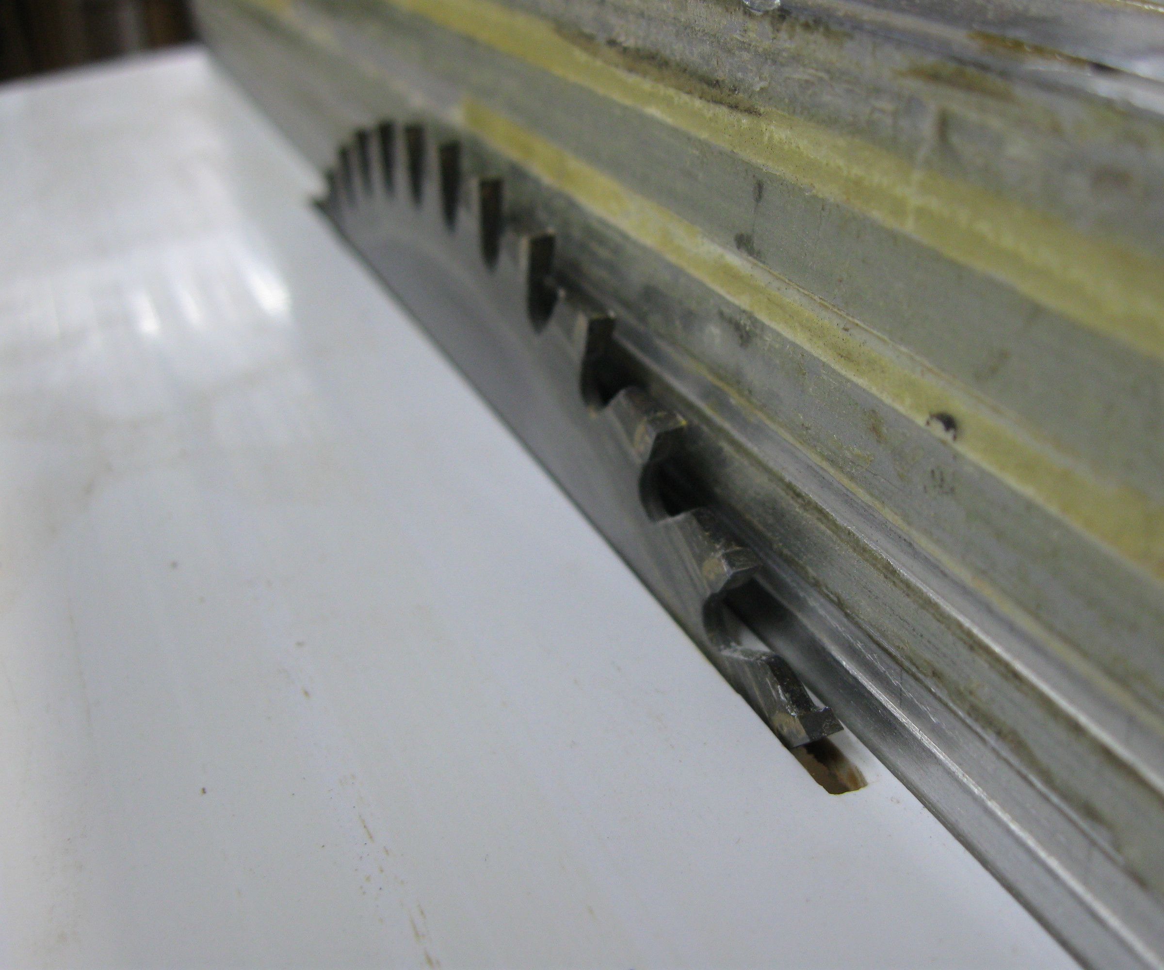

The first step is to rip your wood into Equilateral Triangle strips. The easiest way is to tip your table saw blade to 30º and rip off the first strip. The cut off piece will be half of a full triangle strip, so I saved it and glued it to another strip to make a full triangle. To make one puzzle set you will need a triangle strip about 4.4 times the edge side of the strip. So the strips in the picture are 5cm on the side, so to make one set would take 22cm of stock. I had ripped about 140cm so I was able to make 6 sets. After the strips are cut is a good time to sand all the saw cuts smooth.
