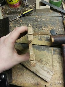

Cutting the waste in the double tenon is easy with a chisel and hand saw. With the blade in a vise I cut the sides of the tenon with a hand saw. Next with the piece flat on the bench we can start to cut the waste off. Line the chisel up at 90 degrees from the workpiece, the chisel edge a little bit away from the shoulder line, and give it a hit with your mallet. Next do the same thing, cutting at an angle towards the cut you just made. Flick away the wedge piece that’ll come out and flip it over to make the same cut on the other side. Keep making these series of cuts, flipping the piece over all the while. After the cut goes through, use finger pressure (if the chisel is sharp enough, you could continue with the mallet) to pare away the material until you make it to the baseline marked before.

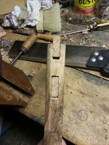

Now to the mortises. This is where the mistake I made resawing the blade comes in. I have a mortise chisel I got from a second hand shop. It’s ⅜” wide which, as I realized after starting to cut the joint, is wider than the blade’s thickness. I should’ve paid more attention to that so then I could make sure that I had a chisel the right size. Using pieces that are the same sizes as your tools can help keep joints more accurate and saves time. So I had to use a regular ¼” chisel and make a lot more cuts than I would have with the other chisel.
The cuts for the mortises are like the cuts for the tenon, though we’ll start at the middle and cut into it in a “V” pattern. So place the chisel in the center, holding it perpendicular to the piece, and strike it with the hammer. Then cut into the same way at an angle towards that center cut, that makes the “V” shape. Repeat that series of cuts, going in deeper and wider, but don’t cut to either end of the mortise yet. Flip the piece over and repeat the cuts until you break through. Then start making straighter cuts towards the marked edges. For the top mortise we do basically do the same thing, but before that we can use hand saw to cut the edges. Now we can try and fit it.
