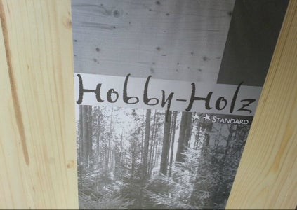

    • Wood
      • 4 - 800 x 400 x 18mm
      • 1 - 800 x 600 x 18mm

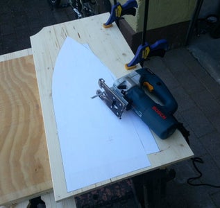

    Start with the top deck shape and draw it in the CAD program (I used Sketchup) or on graph paper. Once the deck is drawn you need to work on the bottom portion of the aircraft carrier. Copy the deck drawing, then shrink it by about 30% (see gold piece). The third piece is a simple boat shape (red piece). Put a 15° angle on this third piece angling the bottom toward the center. For the fourth piece (brown piece), the width of the top edge should equal the bottom of piece three. Put a 15° angle on the fourth piece angling the bottom toward the center. The fifth (final-blue piece) piece should likewise match width to the bottom edge of the fourth piece.
    If using a CAD program like Sketchup, print 1:1 scale. Once all the pages have printed, lay them out and tape together to make your template. The lines should touch but if they don't, make sure all templates match or it could affect the alignment of your pieces.
    Step 3: Cutting & Sanding
    Cut out all five pieces using the jigsaw and dry fit. Note how it all fits together, and make any small adjustments with the jigsaw.

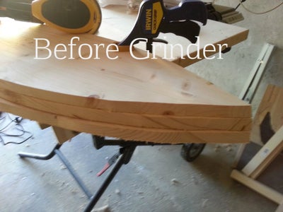

    Line up the three bottom pieces and clamp one side so you can work on the other. If your cuts are really rough, you can try using a grinder with sandpaper for concrete to even the edges out quickly. Remember to keep your angles consistent. When satisfied with this side, move clamps one at a time to other side and repeat.
    After sanding the second side, check the back. Make sure everything is in alignment. I did have a jigsaw blade to cut the thickness but it was quicker to use my miter saw.
    Once the back is done, glue and clamp all three pieces together. I put three screws from the top down for extra holding power.

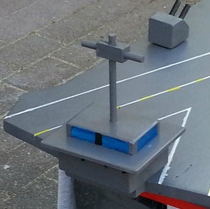

    Lastly, cut out the pieces to the tower, antenna, and cannons. The tower I made with a 2x4 on the deck, plywood as a balcony and 1x2 as the bridge area (see pic). Drill an 8mm hole about 70mm deep in the center of tower for antenna.
    For the antenna, use a 35mm x 15mm block. Drill a hole straight through the center of the 35mm sides. Drill through the center of the 15mm sides. Insert and glue a 150mm dowel through the shorter sides with 20mm sticking out above the block. Insert to midpoint and glue two 35mm length dowels into the long sides.
    For the three cannons, cut a 40mm square block with a 45° angle on one top edge. Flip over and drill an 8mm hole in the center of the flat bottom, 20mm deep. Flip back over and drill two holes into the 45° angle side at the opposite angle (see pic). Glue 70mm dowel into the bottom hole, and two 35mm dowels into the angled holes.

    Install the tower. Tower sits centered on the back tab between the runways. Glue and add two screws up from bottom.
    Install the antenna. Drill a hole 40mm deep into the top of the tower. Insert the dowel of the antenna, without fastening to allow for its rotation.
    Install the cannons. Two cannons sit on either side of the center of the X. Drill an 8mm hole approximately 40mm from each edge, drilling completely through. The front cannon sits centered in the diamond shape wedge at the front of the carrier (see pic for placement), drill an 8mm hole approximately 90mm from the point, stopping at 55mm deep. For the side cannons, place the dowel through the drilled hole, then without holding flush to the deck, glue a round spacer with an 8mm center hole onto the dowel (I used a furniture pad). Be sure no glue gets on the surface, so the cannons will rotate. For the front cannon, just place dowel in the drilled hole. This will not be fastened at all, to allow for its rotation.
