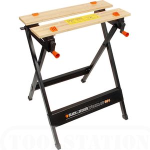

  • vise screws,handles and threaded fittings from a scrap workmate

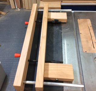

the first step is to decide what joint to use to join the mounts to the rear or fixed jaw, this could be a halflap joint or as in my example a mortise and tenon joint.
I started this by creating a tenon on both the mounting pieces, followed by marking the mortise on the fixed jaw so that the top of the jaw would be flush with the top of the bench, while marking this out it's a good idea to extend the mortise center line passed the mortise a little way towards the center so the holes for the vise screw are centered with the mounts.
With the mortises cut to fit the tenons we need to drill the two holes for the vise screws to pass through, you will need to measure the fittings to find the center for the hole as they vary between brands.
with the holes in the fixed jaw drilled clamp the front jaw to the fixed jaw and drill the front jaw through the fixed jaw so the holes align.
once drilled remove from the fixed jaw and enlarge the holes so the flared section of the vise screw can pass through comfortably (don't make it too tight or the flared section of the vise screw will bind against the jaw during operation).

for the vise to operate we need two metal plates with one hole in the center for the vise screw to pass through and at least 2 mounting holes, these can be either mounted on the front of the vise or recessed so the plate is flush with the front surface of the vise depending on your personal choice, I chose to recess mine but could have done a better job of it.
With the metal plates fitted, and the mounts push fitted into the mortises put the vise screws through the fixed jaw and wind the vise screws all the way into the threaded fittings removed from the workmate, then place your front jaw in position, you should now be able to mark the center line for the fixing bolt through the rear mount.
at this point once assembled you would have a working vise but it would bind up very easy and the jaws would not stay inline very well, to combat this I added the two steel bars to act as guides the ones i chose to use were 16 mm plain steel which used to be a axle taken from an old sack truck (stainless steel would be better), these i have placed on the outer edges of the vise with one end fixed to the front jaw using epoxy resin and the other end passing through the fixed jaw

Apply you preferred wood glue to the tenons of the mounts and fit to the fixed jaw once dry you can further reinforce the joint by adding dowels from the bottom should you choose
fix the guide bars to the front jaw using epoxy resin and leave to cure, once cured (usually over night) you can complete the assembly of the vise then all's left to do is apply your favorite finish and fit to your bench
