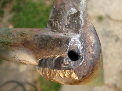

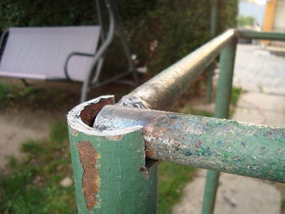

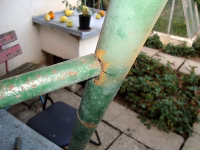

The upper part of the table is made up of 4 tubes welded into a square. Two long, two short, thick as well. In the last figure is seen leg - robust tube.

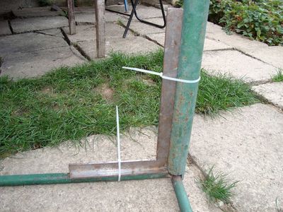

Table legs are made up of thick metal pipes of the same length. Table height choose according to need. The second picture shows the installation of the upper base into the legs. The third and fourth image - link legs together on one side.. at finish on 6th picture.

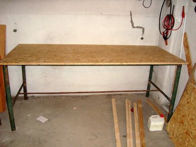

Step 4: Worktop
You can use wooden pallets or wooden board. Alternatively metal grid to give a workbench for welding. Final update - sanded and paint. Not pretty, but functional :)
