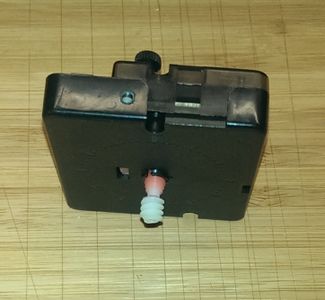

1. Worm drive gear
Take the clock hands off the clock mechanism and carefully identify the "minute" hand drive. All the hands are generally driven by series of concentric plastic cylinders. The minute clock hand will have the right sized hole in it so you can use as a reference for how big the hole in the Worm Drive Gear.
Drill out the worm drive gear so it fits tightly onto the minute hand drive cylinder on the clock mechanism then using 2 part epoxy glue set this in place.

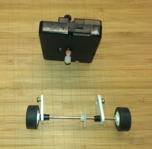

2. Back wheels
Build two wheel mounting brackets from the styrene plastic and drill holes to position the axle in the correct place. Add a bush to each side so that the wheels can turn freely.
Press on the plastic gear to the center of the axle. We will glue this later once other parts are in place.
Attach the back wheels to the clock mechanism using one very short screw in each side and tighten up.
NOTE: Take care to ensure that the mechanism case is not cracked or the inner workings are damaged.
Position the axle so that the worm gear and the axle gear are appropriately meshed. Then glue the gear onto the axle in place and also the two wheel mounting brackets.
Once dry put AA battery into mechanism and use a marker to determine which way you wheels will turn so you can add the front wheel onto the correct end of the clock mechanism.
NOTE: Do not try to turn the wheels manually as worm gears do not allow this and you will break teeth off the gears.
