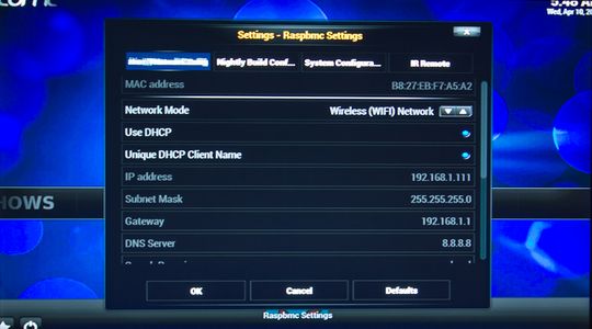

Step 5: Configure Settings
1. After Raspbmc has been installed, you will have the option to choose a language and then be greeted with the home screen. From here you will want to scroll over to the program section and select the Raspbmc settings option. From here, a number of different setting can be changed,
2. Users can change their connection type in the first section for network configuration from wired to wireless if they purchased the wireless adapter. Users will need to enter their wireless router SSID and security information to be able to connect.
3. If you would like the device to run more quickly, settings can be changed in the system configuration section under the System Performance Profile. Changing this value to Fast will overclock the device, which can put more strain on the device but allowing the user interface to run more smoothly.

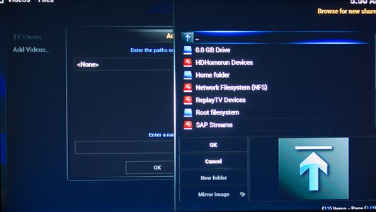

Step 6: Adding Media
This step in our tutorial will involve actually adding your media. We will discuss how to stream media from an existing computer since it is impractical to store it on the device's SD card.
1. Going back to the home menu and navigating to the video option, you should see a drop down option for files. Select that option and you should see a screen that has an option "Add Videos....." Click on this and a popup menu should allow you to browse for a source.
2. Click on browse and a screen should appear with a variety of connection options. XBMC facilitates a number of connections from Network filesystems to UPNP connections. Most computers however will want to use the Windows Samba sharing option towards the bottom.
3. Once you click on this option, it will ask you the user name and password to the windows computer you are trying to stream from. Enter this information and you should be able to browse the files on that computer that you have chosen to share. Find and select the directory containing your media and another screen should appear that allows you to specify what type of media it is and provides the options to automatically scan for album art, artist and cast information, movie cover pictures, ect.
Now that you have added your media, you should now be able to select Movies, TV Shows, or Music from you home screen and begin streaming content from your computer.
