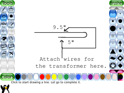

Step 4: Driven Element.
You need to cut a piece of thick copper wire 15 inches long.
(If you do not have access to copper wiring, you could use a folded up folded of piece of foil as a secondary substitute.)
Take the wire and at the 9.5 inch point fold it around a finger into a sort of u-turn.
The remaining length should be 5 inches.
