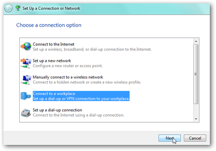

Connecting to the PPTP VPN Server
Once you have your DD-WRT router configured, all that is left is to simply connect your client computers to the VPN. For our example, we will be showing how this is done using Windows 7 Professional.
In the Network and Sharing Center of the Control Panel, click the option to set up a new network connection.
Select the option to connect to a workplace VPN.
If you have existing connections, they will be displayed here. For our example, we want to create a new connection.
Select the option to use your Internet connection to connect to the VPN.
Enter the domain or IP address of your VPN Server (the public IP address of the DD-WRT router configured above) and give a title to the VPN connection.
Enter the credentials for your VPN login which was configured in the DD-WRT router settings. Click Connect.
After a few moments, if everything is configured correctly, you should be connected to the PPTP VPN Server on the DD-WRT router.
Running ‘ipconfig’ on the local machine should show you are connected to both the VPN and your existing internet connection.
Once connected, you can now access all the resources on the VPN as though you were connected to the network locally.
