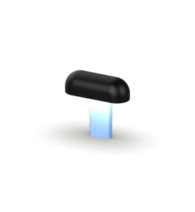

My project is called ZipLight, a sound-sensitive smart desk lamp. When the surrounding noise exceeds a set threshold, the lamp automatically turns off, humorously signaling, “You don’t deserve to study.” It’s designed for libraries or quiet study spaces, reminding people to keep noise levels down.
I’m now using the Arduino Uno as the main controller, which connects to a sound sensor, a transistor, and an LED strip. The Arduino Uno provides standard 5V power and a familiar pin layout, making wiring straightforward. The PAUTIX COB LED strip provides soft, energy-efficient lighting, while the sound sensor detects noise levels. The transistor acts as a switch to control the lamp’s brightness based on the noise threshold.
The lamp is powered via USB, making it simple and practical. With its clean design and functional features, ZipLight is both a fun and effective companion for focused studying!

Step 1: 3D Modeling the Lamp
In this step, we will design the lamp in three separate parts: the lampshade, the stand, and the stand connector. Each part is modeled independently to ensure modularity and ease of assembly. Here's how:
  1. Lampshade:
  2. Design a dome or cone-shaped structure to house the LED strip light.
  3. Add cutouts or grooves for the light to shine through or to fit ventilation if necessary.
  4. Ensure there’s a mechanism (like screw threads or clips) for attaching the lampshade to the stand connector.
  5. Stand:
  6. Create a sturdy vertical pole or support to hold the lampshade at an appropriate height.
  7. Design the base to provide stability. This could be a flat circular or rectangular shape.
  8. Add channels or hooks for cable management if desired.
  9. Stand Connector:
  10. Model a connector piece to join the stand and lampshade securely.
  11. Include slots or screw holes for fixing the lampshade and stand together.
  12. Ensure it allows for easy disassembly if required.
Once the models are complete, export the files in STL format for 3D printing. Ensure the dimensions align properly so the parts fit together seamlessly during assembly.
