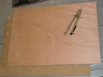

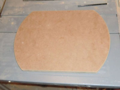

Mark the centre on both sides of one of the bigger plywood piece and draw a circle, the same size as the top of your baseball bat. Lay it on top of your construction, align it and make sure, that it is straight.
Drill at least two holes through the plate into the baseball bat and widen the holes in the table plate a bit. Stick the wooden pole through it, glue it in place and cut it to the correct length.
Glue the two bigger pieces together and draw your wished shield shape onto it. I decided, to make my shield not round, so that it would use up less space in my bedroom.
