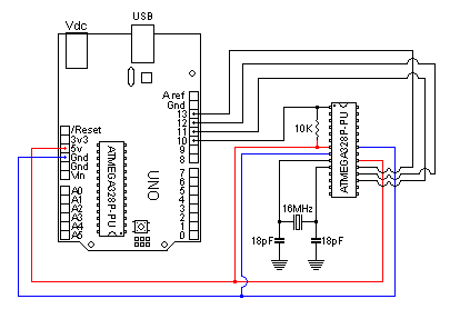

Assemble everything as shown in the figure (on a bread board) :
- arduino board (pin10)->breadboard (pin1)
- arduino board (pin11)->breadboard (pin17)
- arduino board (pin12)->breadboard (pin18)
- arduino board (pin13)->breadboard (pin19)
- (pin 7 ) and (pin20) of breadboard ->+5v of arduino board
- (pin8) and (|pin 22) of breadboard ->gnd of arduino board
- 10 Kohm resistor from(pin 1 ) to +5V
-16 MHZ oscilator from (pin 9 ) to (pin 10)
- 18-22pf caps : first one from (pin 9) to gnd ,second one from pin 10 to gnd

sir,i have an "ATMEGA328 U" IC instead of "ATMEGA328P-PU".icant burn bootloader in it it shows error message like as follows:
avrdude: Expected signature for ATmega328P is 1E 95 0F
Double check chip, or use -F to override this check.
Error while burning bootloader.
can you please help me with a solution.....please!

I was able to add the atmega328-pu to the averdude.conf permanently
1 Copy the whole #Atmega328p section and paste before the next section.
2 In the newly pasted section modify the following fields:
id = "m328";
desc = "ATMEGA328";
signature = 0x1e 0x95 0x14;
