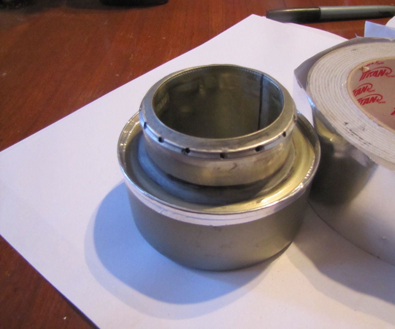

Step 2: Punching the Holes
take the small cat food can wash it really well {this is in case you nick yourself making this thing ..be pretty stupid to loose a finger to blood poisoning for a hobo stove wouldnt it?}
PIC 1and 2 use the hole punch to make a hole in the can as close to the top as you can make it.
PIC 3 make another one exactly opposite.
PIC 4 punch more holes in the middle of each unpunched segment until you have 16 holes. the number isnt super critical but fewer will give you a slower burning stove
Step 3: Time for the Big Tin
PIC 1 now take the cleaned up larger can
PIC 2 punch a hole in the center big enough to get the point of a scissors or tinsnips into it.
PIC 3,4 start a curved cut out to the edge of the crease on the bottom it makes a convenient template but if you want to you could make a smaller hole.
PIC 5 cut the center section out {use the file and sandpaper to clean up the edge of this hole it is razor sharp and most likely barbed.{ i hope you cleaned the can well cause here the most likely spot for a bit of gratuitous bleeding}
PIC 6 ,7,8 use the large can opener to open a triangular flap in the side of the can .then do it seven more times evenly spaced.(be careful here too and sand up the edges]
Step 4: FIT THE BiTS TOGETHER
Time to put the major parts together.
what you should have at this point is a small tin with holes around the rim and a larger one with triangular holes and inward protruding tabs.PIC 1
Pic 2 take the small tin and place it upside down inside the large one.
PIC 3 its essentially finished at this point if you dont have the muffler tape.
PIC 4,5 take enough aluminum muffler tape to go around the can and split it up the middle{you could use it full width but it isnt really necessary .
PIC 6 Wrap the Tape around the can so it forms a tube. then drop the lid in and fold the tape down to hold it all together.
all is left now is to put the fibreglass chunk into the can so its loosely filled. you could also use vermiculite for this too but then you would need to put a fine wire mesh in the top to keep the loose stuff in. the fibreglass will hold its shape after the first burn.
