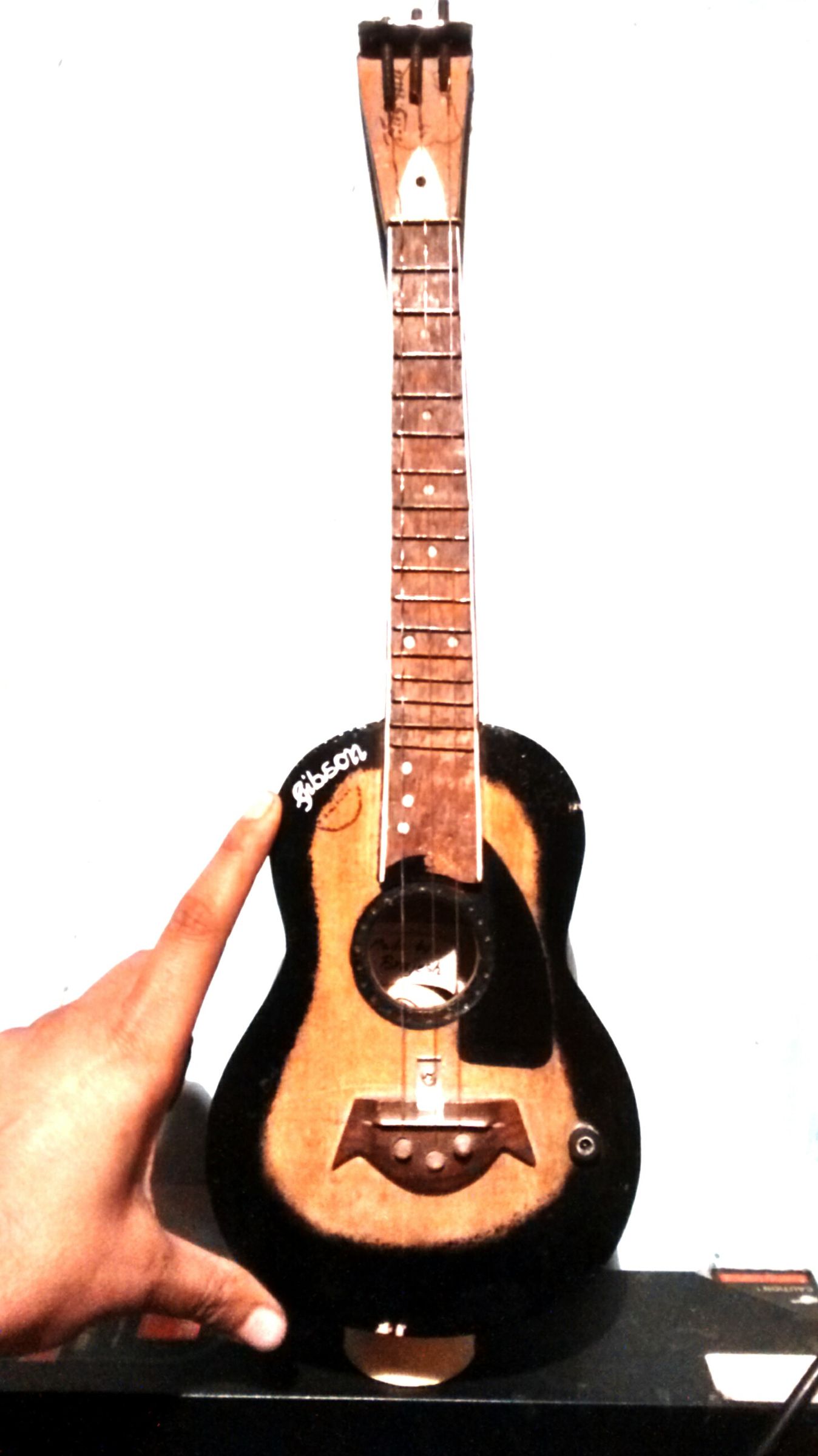

Draw a guitar body figure on the wood and cut the shape. I used sharped screw driver to cut.Put the screw driver on the line and hammer it and so on.You can cut it by any tool if you have.
Make front and back body shape.Make a hole on one of them in 2cm radius.Sand them all by 80 no. sand paper and again by 200no.Sand front and back by 200 no. sand paper and make it smooth.
Now shape the neck.
Glue wood(4*4*1)to neck wood.keep it for a night.
Cut and Remove the wood from side where you glued wood and make it round up to nut.You can use a good knife for this.
The bridge to nut measurement will be 15 inch.Mark bridge and nut on body and neck.Put the neck wood on body and measure it 15 inch.Mark a line on neck where body wood starts.This mark is for gluing body and neck.Cut 1cm deep on this mark.Cut it from other side 90 degree and remove rectangular wood.This 90d shape of neck will be glued on body.Sand them all nicely.
Cut wood 2*18 in 3cm long piece.Make it in about 30 no. Glue all this wood piece on back body on the edge.This will make side body of the guitar.See in the picture.Glue all of these(front,back,side,neck)and keep for a night.Put some weight on this to fit nicely.

glue your bridge on the marked position of body , make three hole of 5mm diameter for putting string.
Cut a groove of 2mm deep on the bridge to fix the bronze piece.
Paint your guitar as you like,put broken guitar string 1,2,3 tune it and enjoy.
