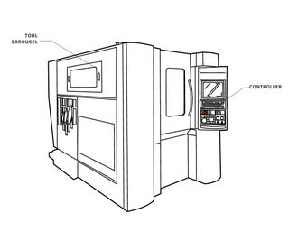

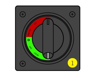

An overview of the operation of the Matsuura 5-Axis Mill including machine specifications, control panel diagrams, allowed materials and basic safety.

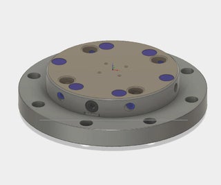

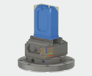

How to install your stock in the machine, perform tool changes, and verify tool length offsets before starting your job.

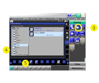

Loading your program into the mill, machining your part and cleaning up after yourself.
